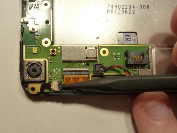

    1. HTC One V Ear Speaker Replacement, Motherboard: crwdns2935265:013crwdnd2935265:01crwdnd2935265:03crwdne2935265:0 HTC One V Ear Speaker Replacement, Motherboard: crwdns2935265:013crwdnd2935265:02crwdnd2935265:03crwdne2935265:0 HTC One V Ear Speaker Replacement, Motherboard: crwdns2935265:013crwdnd2935265:03crwdnd2935265:03crwdne2935265:0
      • Using the spudger lift the tabs on the highlighted, red and orange, ribbon connectors. Gently pull out the ribbons from their connectors.
      • Remove the 3.0 mm Phillips #0 screw.

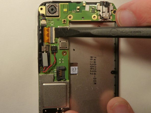

    2. HTC One V Ear Speaker Replacement: crwdns2935265:014crwdnd2935265:01crwdnd2935265:03crwdne2935265:0 HTC One V Ear Speaker Replacement: crwdns2935265:014crwdnd2935265:02crwdnd2935265:03crwdne2935265:0 HTC One V Ear Speaker Replacement: crwdns2935265:014crwdnd2935265:03crwdnd2935265:03crwdne2935265:0
      • Using tweezers, pull back on the tape located on the bottom corners of the motherboard.
    3. HTC One V Ear Speaker Replacement: crwdns2935265:015crwdnd2935265:01crwdnd2935265:02crwdne2935265:0 HTC One V Ear Speaker Replacement: crwdns2935265:015crwdnd2935265:02crwdnd2935265:02crwdne2935265:0
      • Use the spudger to push back the latch holding on the motherboard. While the latch is pushed back use the plastic opening tool to pry up the motherboard.
    4. HTC One V Ear Speaker Replacement: crwdns2935265:016crwdnd2935265:01crwdnd2935265:01crwdne2935265:0
      • Place your phone on its side so that you can gently pull up on the motherboard to expose its last connector.
      • Using the flat end of the spudger, pop of the connector.

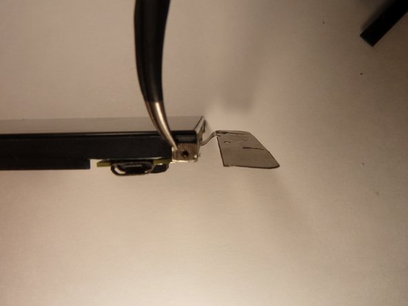

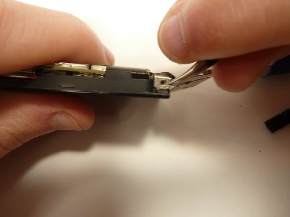

    1. HTC One V Ear Speaker Replacement, Ear Speaker: crwdns2935265:017crwdnd2935265:01crwdnd2935265:01crwdne2935265:0
      • Pull off the ear speaker using the tweezers.
