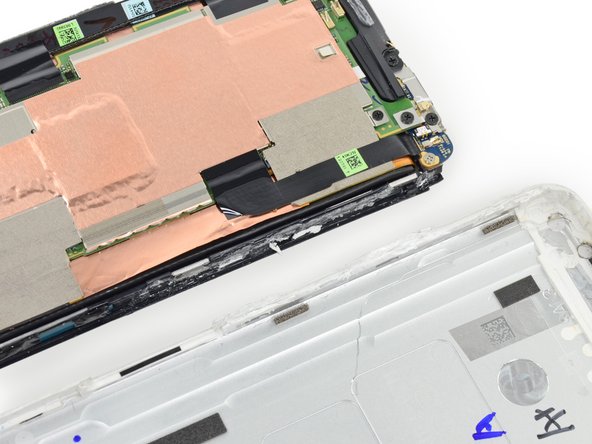

  6. HTC One Teardown: crwdns2935265:06crwdnd2935265:01crwdnd2935265:02crwdne2935265:0 HTC One Teardown: crwdns2935265:06crwdnd2935265:02crwdnd2935265:02crwdne2935265:0
    • We won't lie, getting to this point was an arduous and daunting task. The amount of work required to separate the rear aluminum case and the front case was immense.
    • Nevertheless, we present to you the contents of the One.
    • Our diligent spudgering appears to have permanently mangled the plastic bezel surrounding the aluminum case. It's possible that prying at a snail's pace while applying heat could minimize this damage, but we're not too hopeful. This phone was not made with open-ability in mind.

  8. HTC One Teardown: crwdns2935265:08crwdnd2935265:01crwdnd2935265:02crwdne2935265:0 HTC One Teardown: crwdns2935265:08crwdnd2935265:02crwdnd2935265:02crwdne2935265:0
    • The back of the One is covered in a sea of copper tape and ribbon cables, and only after a diligent search are we able to locate the battery connector—although no clear path to the battery itself.
    • The battery connector is secured to the motherboard with screws. After a couple of turns with our 64 bit kit's precision driver, it's released and ready for removal from the device... but not yet.
  9. HTC One Teardown: crwdns2935265:09crwdnd2935265:01crwdnd2935265:02crwdne2935265:0 HTC One Teardown: crwdns2935265:09crwdnd2935265:02crwdnd2935265:02crwdne2935265:0
    • The motherboard of the HTC One is pretty much encapsulated within copper shielding. Two flat pieces of copper adorn each side of the motherboard.
    • Here's the thing about copper shielding. It dissipates heat and provides electrical grounding. However, copper shielding is a pain to deal with during reassembly—kind of like trying to straighten out aluminum foil once it's been crinkled.

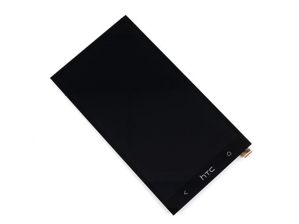

  12. HTC One Teardown: crwdns2935265:012crwdnd2935265:01crwdnd2935265:03crwdne2935265:0 HTC One Teardown: crwdns2935265:012crwdnd2935265:02crwdnd2935265:03crwdne2935265:0 HTC One Teardown: crwdns2935265:012crwdnd2935265:03crwdnd2935265:03crwdne2935265:0
    • The HTC One's 1080P, 468 ppi resolution rivals today's HDTVs and the 10.6" Surface Pro, but in a 4.7" size.
    • Nine steps after prying the display assembly up from the case, we finally get a look at it on its own. Just like we saw earlier with the battery, this component can't be replaced without removing everything from the rear case…and then first taking out the motherboard.
    • There are a number of strange markings on the back of the display panel that we can only identify as the signatures of family physicians.
    • Aside from the inspection notes, the cable is labeled XT6088C07B_FPC REV: 8 DATE: 2012.11.30, indicating that at least certain parts of this phone have been in the works for quite some time.

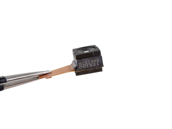

  14. HTC One Teardown: crwdns2935265:014crwdnd2935265:01crwdnd2935265:02crwdne2935265:0 HTC One Teardown: crwdns2935265:014crwdnd2935265:02crwdnd2935265:02crwdne2935265:0
    • Off comes the 2.1 MP front-facing camera.
    • This teeny-tiny unit is labeled H1X1305 067521.
    • Chipworks took apart their HTC One and found OmniVision die marks inside.
