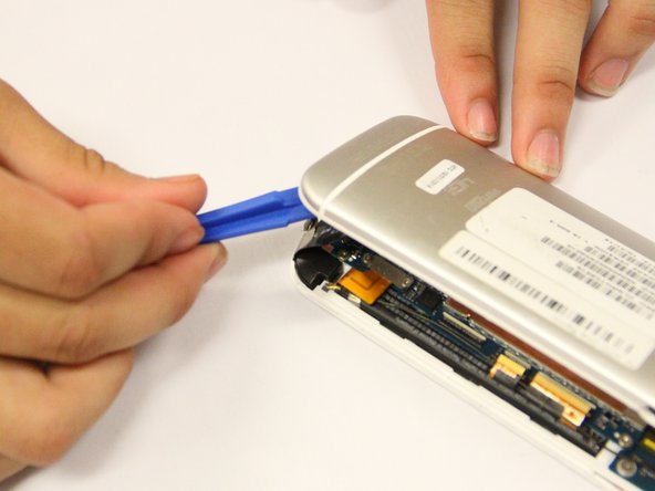

  5. HTC One Remix Motherboard Replacement: crwdns2935265:05crwdnd2935265:01crwdnd2935265:02crwdne2935265:0 HTC One Remix Motherboard Replacement: crwdns2935265:05crwdnd2935265:02crwdnd2935265:02crwdne2935265:0
    • Use the plastic spudger to pry off the back cover. Place the tool in the SIM card insert and lift off the back cover with force. Continue to do this all around the phone.
    • Be careful to not break the wiring that is connected from the inside to the back of the phone.
    • The plastic spudger may not work. If this is the case, you may have to resort to using the metal prying tool. Please use with caution.

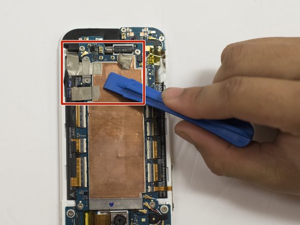

  6. HTC One Remix Motherboard Replacement: crwdns2935265:06crwdnd2935265:01crwdnd2935265:02crwdne2935265:0 HTC One Remix Motherboard Replacement: crwdns2935265:06crwdnd2935265:02crwdnd2935265:02crwdne2935265:0
    • With tweezers, remove the small pieces of yellow tape that hold the phone in place.
    • Use the plastic prying tool to take off the three pieces of silver tape. They are located at the bottom right corner of the copper place.
    • Please note that the second photo is upside-down.

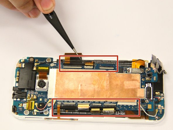

  7. HTC One Remix Motherboard Replacement: crwdns2935265:07crwdnd2935265:01crwdnd2935265:03crwdne2935265:0 HTC One Remix Motherboard Replacement: crwdns2935265:07crwdnd2935265:02crwdnd2935265:03crwdne2935265:0 HTC One Remix Motherboard Replacement: crwdns2935265:07crwdnd2935265:03crwdnd2935265:03crwdne2935265:0
    • With the plastic spudger, disconnect the eight ZIF connectors. Do this by lifting the small white lines up and pulling the ribbon from it.
    • Use tweezers to carefully detach the eight ribbon cables from the connectors.

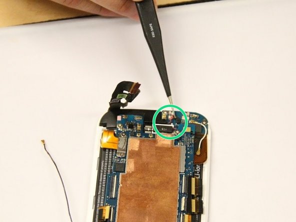

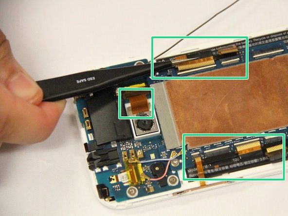

  9. HTC One Remix Motherboard Replacement: crwdns2935265:09crwdnd2935265:01crwdnd2935265:02crwdne2935265:0 HTC One Remix Motherboard Replacement: crwdns2935265:09crwdnd2935265:02crwdnd2935265:02crwdne2935265:0
    • Pull off one end of each of the five colored connecting cables from the motherboard.
    • Pull the black and red wire from the motherboard on the bottom left.
