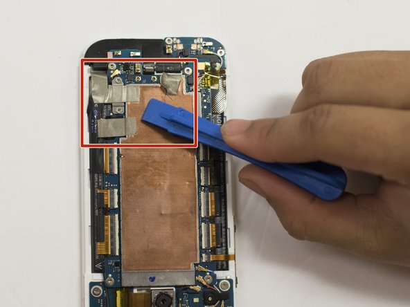

    • Once the top of the phone is warm, use a plastic spudger to pry up the left corner and pull it off.
    • The top is glued on so it may be difficult to pull off.

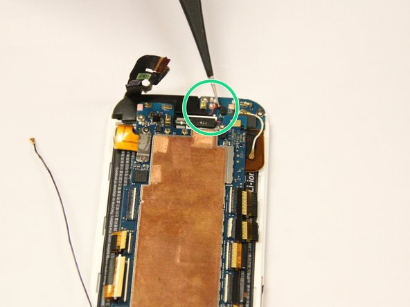

  4. HTC One Remix Battery Replacement: crwdns2935265:04crwdnd2935265:01crwdnd2935265:01crwdne2935265:0
    • Take out the single 3mm screw that is on the top left side using a Torx 4 screwdriver.

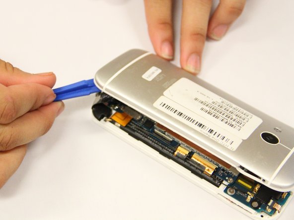

  5. HTC One Remix Battery Replacement: crwdns2935265:05crwdnd2935265:01crwdnd2935265:02crwdne2935265:0 HTC One Remix Battery Replacement: crwdns2935265:05crwdnd2935265:02crwdnd2935265:02crwdne2935265:0
    • Use the plastic spudger to pry off the back cover. Place the tool in the SIM card insert and lift the back cover with force. Continue to do this all around the phone.
    • Be careful not to break the wiring that is connected from the inside of the phone to the back of the phone.

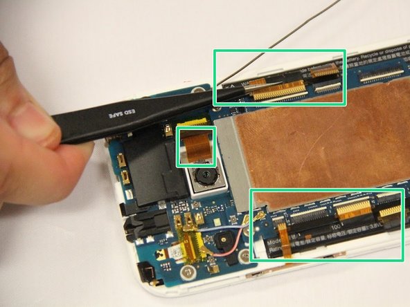

  6. HTC One Remix Battery Replacement: crwdns2935265:06crwdnd2935265:01crwdnd2935265:02crwdne2935265:0 HTC One Remix Battery Replacement: crwdns2935265:06crwdnd2935265:02crwdnd2935265:02crwdne2935265:0
    • With tweezers, remove the small pieces of yellow tape that cover the ZIF connectors.
    • Use the plastic prying tool to take off the three pieces of silver tape. They are located at the bottom right corner of the copper plate.

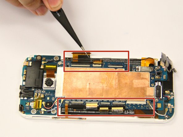

  7. HTC One Remix Battery Replacement: crwdns2935265:07crwdnd2935265:01crwdnd2935265:03crwdne2935265:0 HTC One Remix Battery Replacement: crwdns2935265:07crwdnd2935265:02crwdnd2935265:03crwdne2935265:0 HTC One Remix Battery Replacement: crwdns2935265:07crwdnd2935265:03crwdnd2935265:03crwdne2935265:0
    • With the plastic spudger, disconnect the eight ZIF connectors.
    • Use tweezers to carefully detach the eight ribbon cables from the ZIF connectors.

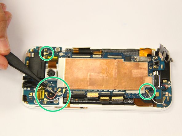

  9. HTC One Remix Battery Replacement: crwdns2935265:09crwdnd2935265:01crwdnd2935265:03crwdne2935265:0 HTC One Remix Battery Replacement: crwdns2935265:09crwdnd2935265:02crwdnd2935265:03crwdne2935265:0 HTC One Remix Battery Replacement: crwdns2935265:09crwdnd2935265:03crwdnd2935265:03crwdne2935265:0
    • Pull off one end of each of the five colored connecting cables from the motherboard.
    • Pull back the black and red wire on the motherboard on the bottom left.
