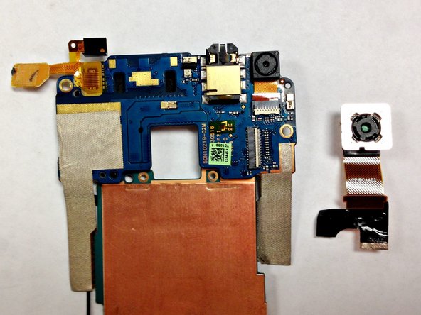

  18. HTC One Mini Rear Facing Camera Replacement, Rear Facing Camera: crwdns2935265:018crwdnd2935265:01crwdnd2935265:01crwdne2935265:0
    • Remove the motherboard and place it so that the rear camera is face down.

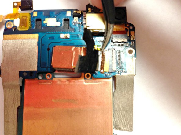

  19. HTC One Mini Rear Facing Camera Replacement: crwdns2935265:019crwdnd2935265:01crwdnd2935265:01crwdne2935265:0
    • Use the tweezers to carefully peel back the copper tape attached to your rear camera.
  20. HTC One Mini Rear Facing Camera Replacement: crwdns2935265:020crwdnd2935265:01crwdnd2935265:03crwdne2935265:0 HTC One Mini Rear Facing Camera Replacement: crwdns2935265:020crwdnd2935265:02crwdnd2935265:03crwdne2935265:0 HTC One Mini Rear Facing Camera Replacement: crwdns2935265:020crwdnd2935265:03crwdnd2935265:03crwdne2935265:0
    • Use the tweezers to lift the hatch and remove the part of the rear camera that is inserted.
