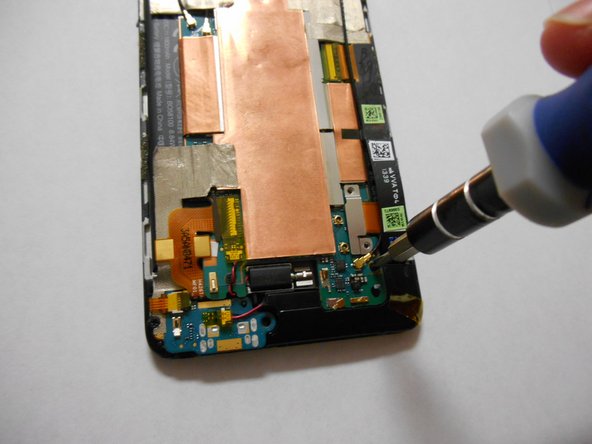

  9. HTC One Mini Motherboard Replacement, Remove Screws: crwdns2935265:09crwdnd2935265:01crwdnd2935265:03crwdne2935265:0 HTC One Mini Motherboard Replacement, Remove Screws: crwdns2935265:09crwdnd2935265:02crwdnd2935265:03crwdne2935265:0 HTC One Mini Motherboard Replacement, Remove Screws: crwdns2935265:09crwdnd2935265:03crwdnd2935265:03crwdne2935265:0
    • Remove the two small black Phillips screws.

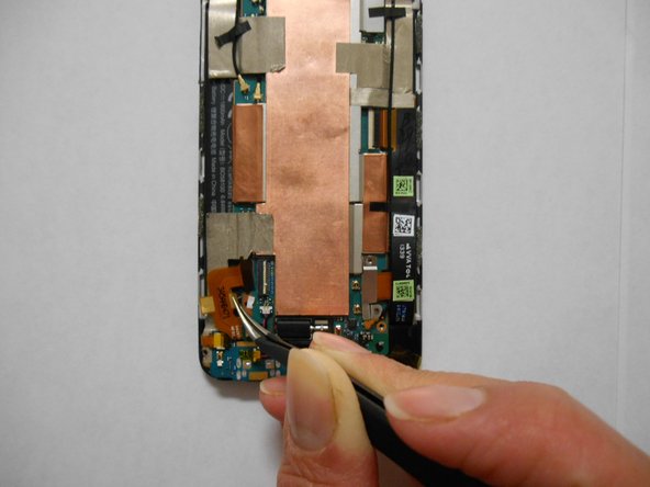

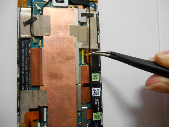

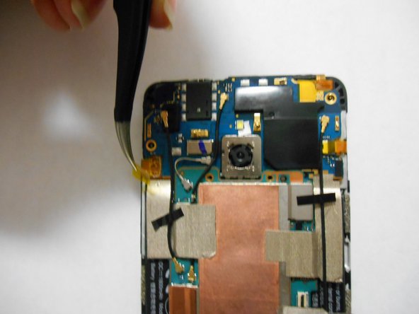

  11. HTC One Mini Motherboard Replacement, Remove protective foil.: crwdns2935265:011crwdnd2935265:01crwdnd2935265:03crwdne2935265:0 HTC One Mini Motherboard Replacement, Remove protective foil.: crwdns2935265:011crwdnd2935265:02crwdnd2935265:03crwdne2935265:0 HTC One Mini Motherboard Replacement, Remove protective foil.: crwdns2935265:011crwdnd2935265:03crwdnd2935265:03crwdne2935265:0
    • Use tweezers to remove the yellow tape covering the flex cable connectors (total of five).

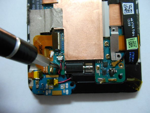

  12. HTC One Mini Motherboard Replacement: crwdns2935265:012crwdnd2935265:01crwdnd2935265:02crwdne2935265:0 HTC One Mini Motherboard Replacement: crwdns2935265:012crwdnd2935265:02crwdnd2935265:02crwdne2935265:0
    • Carefully disconnect the flex cables at the points where you removed the yellow tape in the previous steps.
    • To disconnect, flip up the small latch on each connector, opposite its cable, and then gently pull the cable free.

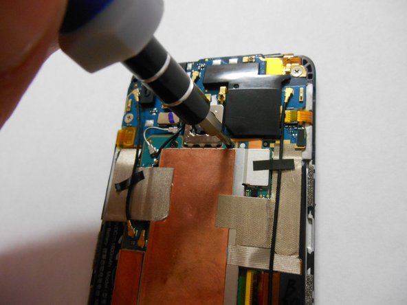

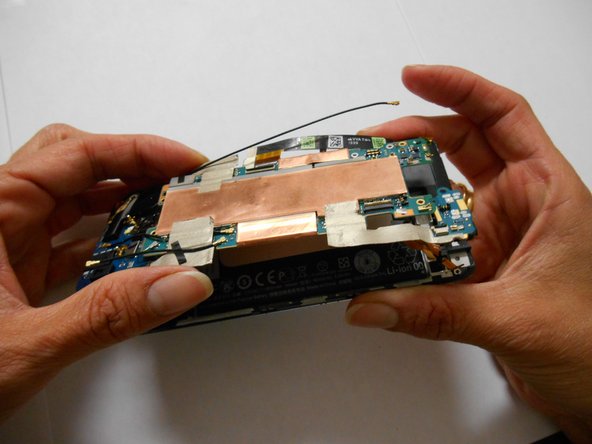

  15. HTC One Mini Motherboard Replacement: crwdns2935265:015crwdnd2935265:01crwdnd2935265:03crwdne2935265:0 HTC One Mini Motherboard Replacement: crwdns2935265:015crwdnd2935265:02crwdnd2935265:03crwdne2935265:0 HTC One Mini Motherboard Replacement: crwdns2935265:015crwdnd2935265:03crwdnd2935265:03crwdne2935265:0
    • Identify the screw behind the cable.
    • Remove the screw using a Phillips screwdriver.
  16. HTC One Mini Motherboard Replacement: crwdns2935265:016crwdnd2935265:01crwdnd2935265:02crwdne2935265:0 HTC One Mini Motherboard Replacement: crwdns2935265:016crwdnd2935265:02crwdnd2935265:02crwdne2935265:0
    • Lift the motherboard, but don't try to remove it completely yet.
    • Handle the board only by the edges.
  17. HTC One Mini Motherboard Replacement: crwdns2935265:017crwdnd2935265:01crwdnd2935265:03crwdne2935265:0 HTC One Mini Motherboard Replacement: crwdns2935265:017crwdnd2935265:02crwdnd2935265:03crwdne2935265:0 HTC One Mini Motherboard Replacement: crwdns2935265:017crwdnd2935265:03crwdnd2935265:03crwdne2935265:0
    • Using your tweezers, remove the black square located in the power button.
    • Remove the motherboard completely.
