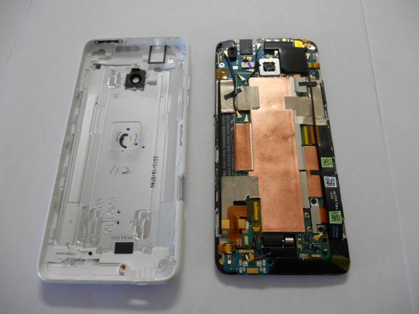

      • Use force to pry and separate the rear panel.
    5. HTC One Mini LCD Display Replacement, Separate Rear Case: crwdns2935265:05crwdnd2935265:01crwdnd2935265:02crwdne2935265:0 HTC One Mini LCD Display Replacement, Separate Rear Case: crwdns2935265:05crwdnd2935265:02crwdnd2935265:02crwdne2935265:0
      • Separate the rear panel from the phone.

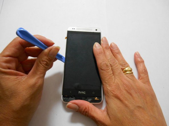

    6. HTC One Mini LCD Display Replacement: crwdns2935265:06crwdnd2935265:01crwdnd2935265:02crwdne2935265:0 HTC One Mini LCD Display Replacement: crwdns2935265:06crwdnd2935265:02crwdnd2935265:02crwdne2935265:0
      • Using the plastic opening tool, pry on the screen to separate it from the adhesive holding it.

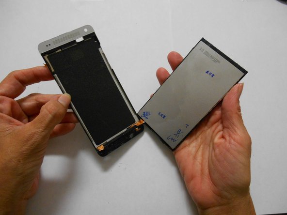

    7. HTC One Mini LCD Display Replacement, Separate LCD Screen: crwdns2935265:07crwdnd2935265:01crwdnd2935265:02crwdne2935265:0 HTC One Mini LCD Display Replacement, Separate LCD Screen: crwdns2935265:07crwdnd2935265:02crwdnd2935265:02crwdne2935265:0
      • After you have used the opening tool to pry, use some force to separate the LCD screen from the glue.
