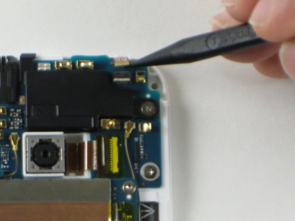

  6. HTC One Mini 2 Power and Volume Buttons Replacement, Power and Volume Buttons: crwdns2935265:06crwdnd2935265:01crwdnd2935265:02crwdne2935265:0 HTC One Mini 2 Power and Volume Buttons Replacement, Power and Volume Buttons: crwdns2935265:06crwdnd2935265:02crwdnd2935265:02crwdne2935265:0
    • Use the pointed end of a spudger to peel the yellow tape off of the power button connector.
  7. HTC One Mini 2 Power and Volume Buttons Replacement: crwdns2935265:07crwdnd2935265:01crwdnd2935265:02crwdne2935265:0 HTC One Mini 2 Power and Volume Buttons Replacement: crwdns2935265:07crwdnd2935265:02crwdnd2935265:02crwdne2935265:0
    • Using the pointed end of the spudger, pop up the small white tab on the power button connector.
    • Gently pull the ribbon cable out of the connector.

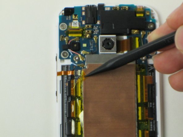

  9. HTC One Mini 2 Power and Volume Buttons Replacement: crwdns2935265:09crwdnd2935265:01crwdnd2935265:02crwdne2935265:0 HTC One Mini 2 Power and Volume Buttons Replacement: crwdns2935265:09crwdnd2935265:02crwdnd2935265:02crwdne2935265:0
    • Use the pointed end of a spudger to peel off the yellow tape from the volume button connector.
    • The connector is found at the top left corner of the copper plate.
