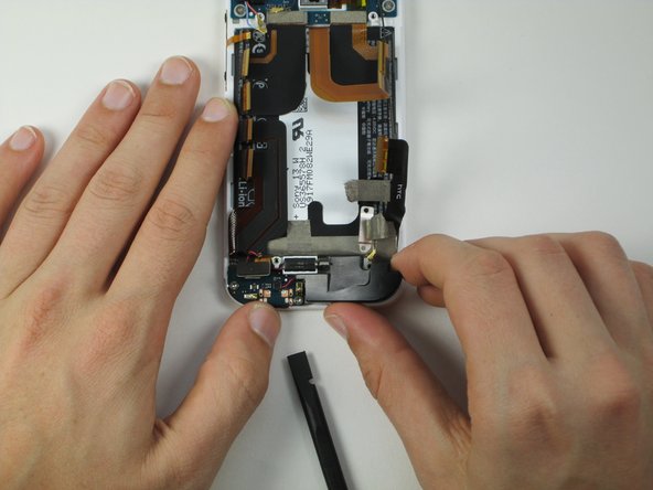

  13. HTC One Mini 2 Dual Speakers Replacement, Dual Speakers: crwdns2935265:013crwdnd2935265:01crwdnd2935265:02crwdne2935265:0 HTC One Mini 2 Dual Speakers Replacement, Dual Speakers: crwdns2935265:013crwdnd2935265:02crwdnd2935265:02crwdne2935265:0
    • Use the flat end of the plastic spudger to pry the lower speaker out.
    • Holding the phone, pull the speaker to the right pulling the connector out of the board.
    • The connector is very small and easy to break so take caution when pulling it out. Wiggling the wires as you pull to the right helps.

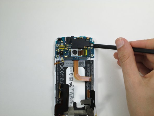

  14. HTC One Mini 2 Dual Speakers Replacement: crwdns2935265:014crwdnd2935265:01crwdnd2935265:01crwdne2935265:0
    • Using the narrow pry tool, pry the rear camera loose from the frame.
  15. HTC One Mini 2 Dual Speakers Replacement, Top Speaker: crwdns2935265:015crwdnd2935265:01crwdnd2935265:02crwdne2935265:0 HTC One Mini 2 Dual Speakers Replacement, Top Speaker: crwdns2935265:015crwdnd2935265:02crwdnd2935265:02crwdne2935265:0
    • Peel off the yellow tape covering the power button connector using the pointed end of the spudger.
    • Pop up the white tab on the ribbon cable connector for the power button located on the top right of the phone.
    • Carefully pull out the ribbon cable.

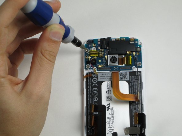

  16. HTC One Mini 2 Dual Speakers Replacement: crwdns2935265:016crwdnd2935265:01crwdnd2935265:03crwdne2935265:0 HTC One Mini 2 Dual Speakers Replacement: crwdns2935265:016crwdnd2935265:02crwdnd2935265:03crwdne2935265:0 HTC One Mini 2 Dual Speakers Replacement: crwdns2935265:016crwdnd2935265:03crwdnd2935265:03crwdne2935265:0
    • Using a PH000 Phillips screwdriver, remove the four 1mm screws from the upper logic board.
    • Using the flat end of the spudger, pop the top speaker's plastic cover off.
    • Lift out the board with the camera and set it aside for reassembly.

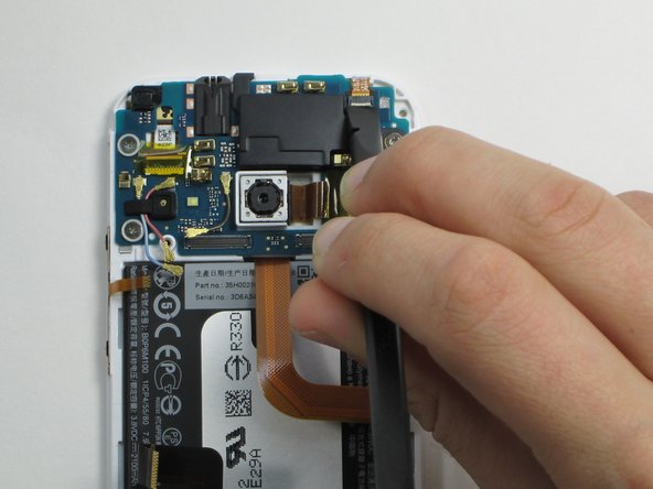

  17. HTC One Mini 2 Dual Speakers Replacement: crwdns2935265:017crwdnd2935265:01crwdnd2935265:01crwdne2935265:0
    • Using a 2 mm flat head screwdriver, pry out and remove the top speaker from the phone.
    • It is easy to pry the speaker apart rather than pry the whole thing out. So be careful to only pry on the metal plate and not the plastic siding of the speaker.
