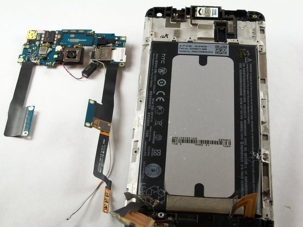

    6. HTC One Max Rear Facing Camera Replacement: crwdns2935265:011crwdnd2935265:01crwdnd2935265:02crwdne2935265:0 HTC One Max Rear Facing Camera Replacement: crwdns2935265:011crwdnd2935265:02crwdnd2935265:02crwdne2935265:0
      • Use a plastic tool to lift and remove the motherboard.
      • Use a heat gun to loosen adhesive at bottom if needed.

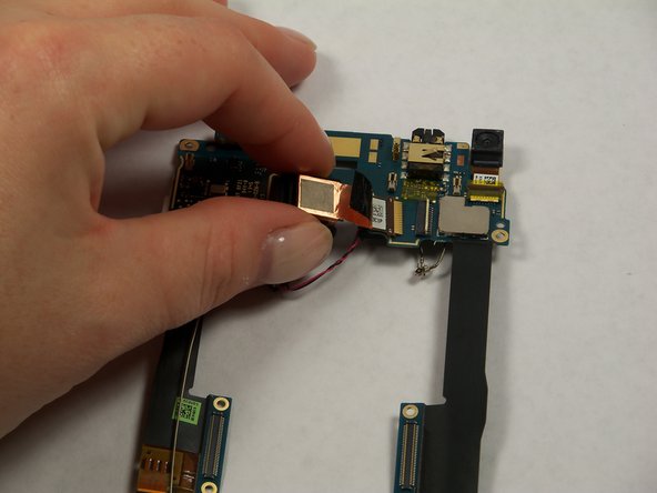

      • Peel back infrared sensor.

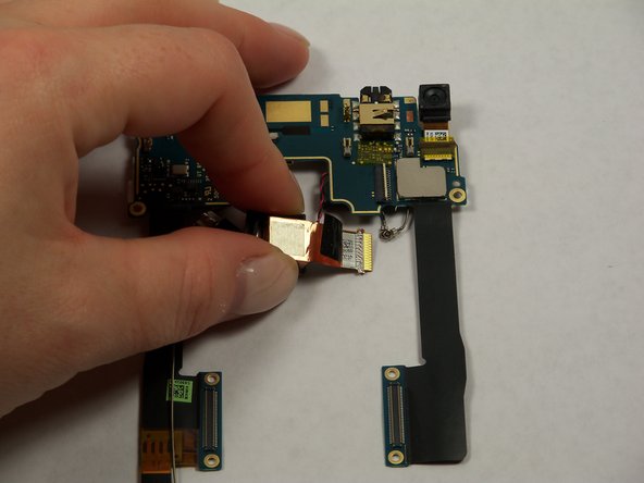

    1. HTC One Max Rear Facing Camera Replacement, Rear Facing Camera: crwdns2935265:015crwdnd2935265:01crwdnd2935265:02crwdne2935265:0 HTC One Max Rear Facing Camera Replacement, Rear Facing Camera: crwdns2935265:015crwdnd2935265:02crwdnd2935265:02crwdne2935265:0
      • Lift the secondary motherboard with the camera attached.
    2. HTC One Max Rear Facing Camera Replacement: crwdns2935265:016crwdnd2935265:01crwdnd2935265:03crwdne2935265:0 HTC One Max Rear Facing Camera Replacement: crwdns2935265:016crwdnd2935265:02crwdnd2935265:03crwdne2935265:0 HTC One Max Rear Facing Camera Replacement: crwdns2935265:016crwdnd2935265:03crwdnd2935265:03crwdne2935265:0
      • Use a plastic opening tool to disconnect the camera ribbon cable.
      • Remove rear camera.
