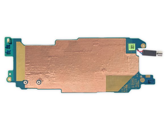

  9. HTC One M9 Teardown: crwdns2935265:09crwdnd2935265:01crwdnd2935265:02crwdne2935265:0 HTC One M9 Teardown: crwdns2935265:09crwdnd2935265:02crwdnd2935265:02crwdne2935265:0
    • Augh! What is this? Looks like HTC's engineers weren't interested in our input from the M8. They've stuck with their habit of gluing down the motherboard.
    • Not only is the motherboard adhered, it's bang up against the battery—a "soft" battery.
    • After some very gentle prying with a blunt spudger, we manage to free the motherboard and not catch fire.
    • Phew!
    • Oh and the rotational vibrator? Yeah, it's now soldered to the motherboard, and (lightly) adhered to the case.
    • No more connector, and no more snug sleeve. Replacement just got a notch more involved.

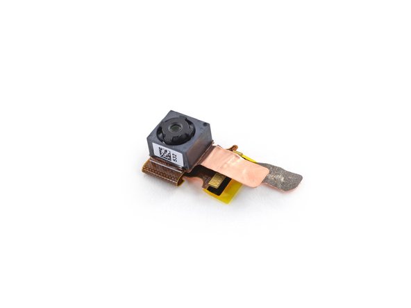

  13. HTC One M9 Teardown: crwdns2935265:013crwdnd2935265:01crwdnd2935265:03crwdne2935265:0 HTC One M9 Teardown: crwdns2935265:013crwdnd2935265:02crwdnd2935265:03crwdne2935265:0 HTC One M9 Teardown: crwdns2935265:013crwdnd2935265:03crwdnd2935265:03crwdne2935265:0
    • We want to get a look at the M9's Highly Touted Camera. After one last connector, a few more screws, and some adhesive, the daughterboard is finally free.
    • And with it, the newly single rear-facing camera.
    • You go, camera—you are a strong independent image capturing component that doesn't need any gimmicky 3D to define you.
    • The M9's 20 MP rear camera sports a sapphire cover lens—possibly in response to criticism of an easily-scratched cover on the M8. HTC seemingly took a cue from Apple and introduced some camera bling.
