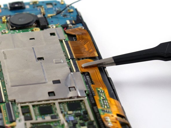

    2. HTC One M8 Display Assembly Replacement: crwdns2935265:011crwdnd2935265:01crwdnd2935265:03crwdne2935265:0 HTC One M8 Display Assembly Replacement: crwdns2935265:011crwdnd2935265:02crwdnd2935265:03crwdne2935265:0 HTC One M8 Display Assembly Replacement: crwdns2935265:011crwdnd2935265:03crwdnd2935265:03crwdne2935265:0
      • Use a spudger to disconnect the two ZIF connectors.
      • Use the flat end of a spudger to disconnect the black antenna cable.
      • Use a set of tweezers to pull the two ribbon cables free of the ZIF connectors.

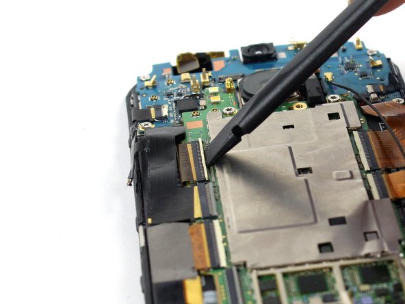

    1. HTC One M8 Display Assembly Replacement, Display Assembly: crwdns2935265:013crwdnd2935265:01crwdnd2935265:03crwdne2935265:0 HTC One M8 Display Assembly Replacement, Display Assembly: crwdns2935265:013crwdnd2935265:02crwdnd2935265:03crwdne2935265:0 HTC One M8 Display Assembly Replacement, Display Assembly: crwdns2935265:013crwdnd2935265:03crwdnd2935265:03crwdne2935265:0
      • Use the tip of a spudger to disconnect the seven ZIF connectors.
      • Use a pair of tweezers to gently pull the seven ribbon cables free of the connectors.

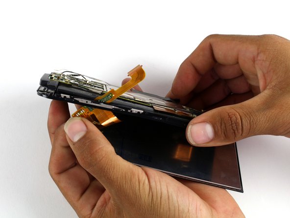

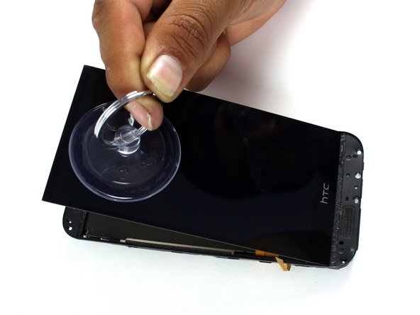

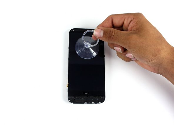

    2. HTC One M8 Display Assembly Replacement: crwdns2935265:014crwdnd2935265:01crwdnd2935265:03crwdne2935265:0 HTC One M8 Display Assembly Replacement: crwdns2935265:014crwdnd2935265:02crwdnd2935265:03crwdne2935265:0 HTC One M8 Display Assembly Replacement: crwdns2935265:014crwdnd2935265:03crwdnd2935265:03crwdne2935265:0
      • Use an iOpener to loosen the adhesive securing the display assembly to the rest of the device.
      • Use a suction cup to gently separate the display assembly from the rest of the device.
    3. HTC One M8 Display Assembly Replacement: crwdns2935265:015crwdnd2935265:01crwdnd2935265:03crwdne2935265:0 HTC One M8 Display Assembly Replacement: crwdns2935265:015crwdnd2935265:02crwdnd2935265:03crwdne2935265:0 HTC One M8 Display Assembly Replacement: crwdns2935265:015crwdnd2935265:03crwdnd2935265:03crwdne2935265:0
      • Carefully guide the display assembly ribbon cable through the midframe for removal.

Great guide - many thanks!
In step 13, you only need to disconnect four ZIF connectors - the top two on the left and top one on the right can be left connected.
Thanks again!
Byrn

don't follow step 13 in fact &&^& this guide listen to byrn
