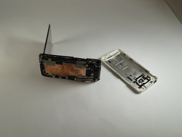

      • Once the screen has been loosened on the top, left and right edges, lift the screen.
      • The screen will stay on a hinge until the final step.
    4. HTC One Front Panel Replacement: crwdns2935265:04crwdnd2935265:01crwdnd2935265:01crwdne2935265:0
      • Gently remove the volume button. Using the plastic opening tool, loosen the back panel of the phone. Begin in the space where the battery was and work around the phone, following the crease of the back panel.
    5. HTC One Front Panel Replacement: crwdns2935265:05crwdnd2935265:01crwdnd2935265:02crwdne2935265:0 HTC One Front Panel Replacement: crwdns2935265:05crwdnd2935265:02crwdnd2935265:02crwdne2935265:0
      • Pry the back open once loose and lift. The back panel will come off with time.

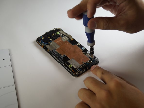

    6. HTC One Front Panel Replacement: crwdns2935265:06crwdnd2935265:01crwdnd2935265:03crwdne2935265:0 HTC One Front Panel Replacement: crwdns2935265:06crwdnd2935265:02crwdnd2935265:03crwdne2935265:0 HTC One Front Panel Replacement: crwdns2935265:06crwdnd2935265:03crwdnd2935265:03crwdne2935265:0
      • Remove all the #000 screws with a #000 Phillips screw driver
      • Some screws are hidden by tape so remove the tape and check for screws.

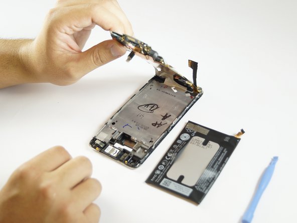

    9. HTC One Front Panel Replacement: crwdns2935265:09crwdnd2935265:01crwdnd2935265:02crwdne2935265:0 HTC One Front Panel Replacement: crwdns2935265:09crwdnd2935265:02crwdnd2935265:02crwdne2935265:0
      • Lift the motherboard completely out of the phone. (may stay attached at the bottom by tape)

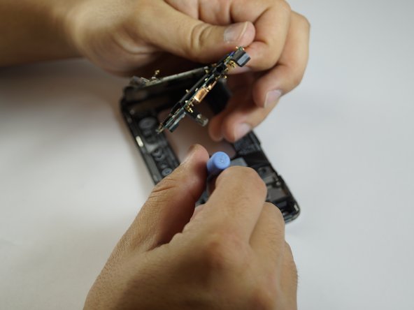

    10. HTC One Front Panel Replacement: crwdns2935265:010crwdnd2935265:01crwdnd2935265:02crwdne2935265:0 HTC One Front Panel Replacement: crwdns2935265:010crwdnd2935265:02crwdnd2935265:02crwdne2935265:0
      • Use the blue opening tool to pry up the battery from the frame.
      • The battery is glued to the frame so you will have to put force.
      • Do not break the battery upon removal.
