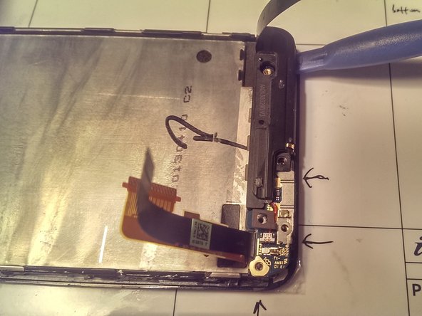

    4. HTC One Display Assembly Replacement, Tape Removal: crwdns2935265:04crwdnd2935265:01crwdnd2935265:02crwdne2935265:0 HTC One Display Assembly Replacement, Tape Removal: crwdns2935265:04crwdnd2935265:02crwdnd2935265:02crwdne2935265:0
      • Remove the three pieces of black electrical tape using an exacto knife or razor blade
      • There is a lot of black electrical tape and silver colored tape to remove throughout the process
      • The black coaxial cable that runs near the gray and blue cable is present only in certain models. This phone in the picture is the Sprint model and has CDMA antennas that will be in addition to GSM phone models.

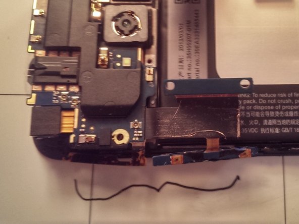

    5. HTC One Display Assembly Replacement, Coaxial Cable Removal: crwdns2935265:05crwdnd2935265:01crwdnd2935265:01crwdne2935265:0
      • Remove the five coaxial cables using tweezers
      • They are easy to pop out by applying a little pulling pressure

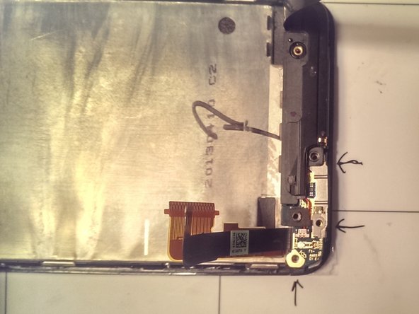

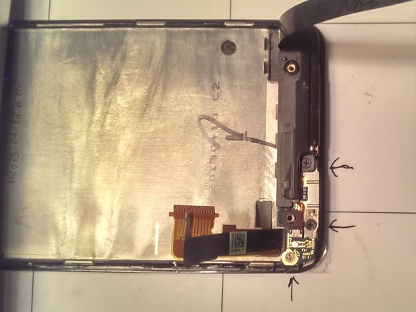

    6. HTC One Display Assembly Replacement, Flex Cable Removal: crwdns2935265:06crwdnd2935265:01crwdnd2935265:01crwdne2935265:0
      • In order to remove the motherboard, the flex cables must be demated
      • First remove the four flex cables indicated with arrows. Some of the metallic colored tape will need to be peeled back in order to access these.
      • The flex cables are held in place using ZIF (zero insertion force) connectors.
      • For the top two and the bottom left (in the photo) the black tab needs to be carefully opened using a plastic prying tool in order to remove the flex cable.
      • For the bottom right connector, the white tab needs to be carefully lifted up with a plastic prying tool in order to release the flex cable.

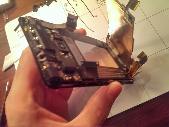

    9. HTC One Display Assembly Replacement, Motherboard Removal: crwdns2935265:09crwdnd2935265:01crwdnd2935265:03crwdne2935265:0 HTC One Display Assembly Replacement, Motherboard Removal: crwdns2935265:09crwdnd2935265:02crwdnd2935265:03crwdne2935265:0 HTC One Display Assembly Replacement, Motherboard Removal: crwdns2935265:09crwdnd2935265:03crwdnd2935265:03crwdne2935265:0
      • Pull the motherboard up from the side shown in the image
      • The motherboard is held down on one end with the metallic colored tape and comes up with light pulling with your hand

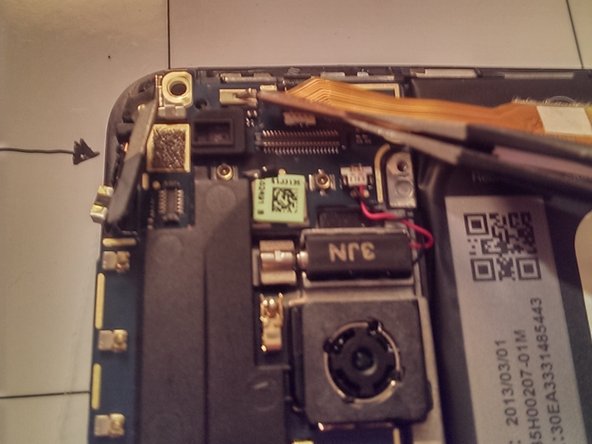

    12. HTC One Display Assembly Replacement, Power Button and Flex Cable Removal: crwdns2935265:012crwdnd2935265:01crwdnd2935265:02crwdne2935265:0 HTC One Display Assembly Replacement, Power Button and Flex Cable Removal: crwdns2935265:012crwdnd2935265:02crwdnd2935265:02crwdne2935265:0
      • Disconnect these two pop connectors by gently prying up from the daughterboard with blunt tipped tweezers
    13. HTC One Display Assembly Replacement, Flex Cable Removal: crwdns2935265:013crwdnd2935265:01crwdnd2935265:02crwdne2935265:0 HTC One Display Assembly Replacement, Flex Cable Removal: crwdns2935265:013crwdnd2935265:02crwdnd2935265:02crwdne2935265:0
      • Detatch the flex cable by flipping up on the white portion of the ZIF connector. This releases the flex cable
      • Gently pull the flex cable from the connector

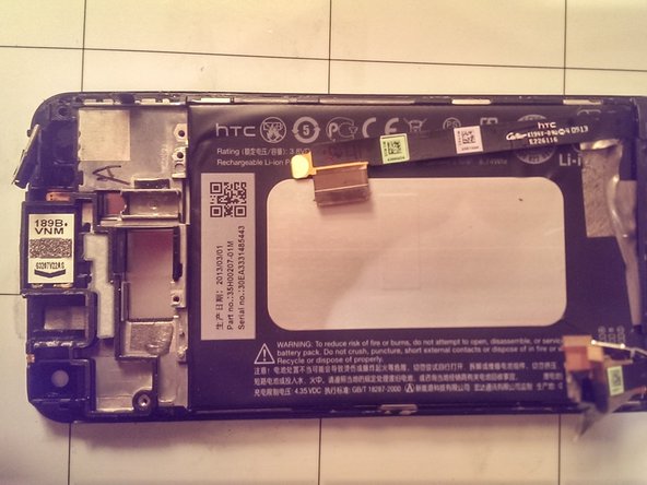

    14. HTC One Display Assembly Replacement, Vibrator Motor Removal: crwdns2935265:014crwdnd2935265:01crwdnd2935265:01crwdne2935265:0
      • Release the vibrator motor by prying up on the moving end of the motor
      • The vibrator motor is connected by two wires to daughterboard and does not need to be detached from the daughterboard, just released from its slot in the housing

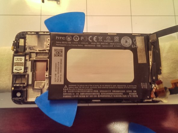

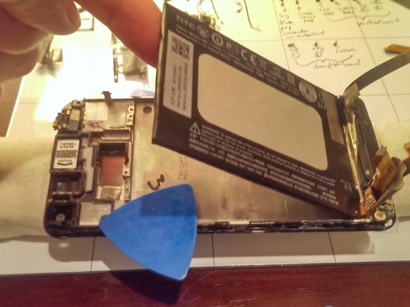

    16. HTC One Display Assembly Replacement, Battery Removal: crwdns2935265:016crwdnd2935265:01crwdnd2935265:03crwdne2935265:0 HTC One Display Assembly Replacement, Battery Removal: crwdns2935265:016crwdnd2935265:02crwdnd2935265:03crwdne2935265:0 HTC One Display Assembly Replacement, Battery Removal: crwdns2935265:016crwdnd2935265:03crwdnd2935265:03crwdne2935265:0
      • There is an adhesive holding down the battery. Place the hot iOpener on top of the battery for a minute.
      • Then place the iOpener onto the table and place the phone glass against it to heat the adhesive from the other side.
      • As the phone is lying on the iOpener, softly pry away the battery using the plastic picks. The battery flexes slightly so pry away gently.

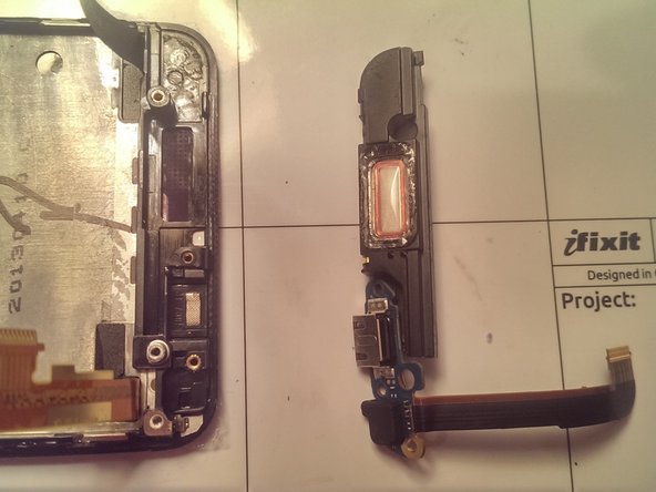

    18. HTC One Display Assembly Replacement, Small Logic Board: crwdns2935265:018crwdnd2935265:01crwdnd2935265:02crwdne2935265:0 HTC One Display Assembly Replacement, Small Logic Board: crwdns2935265:018crwdnd2935265:02crwdnd2935265:02crwdne2935265:0
      • The small logic board and metal piece are shown here

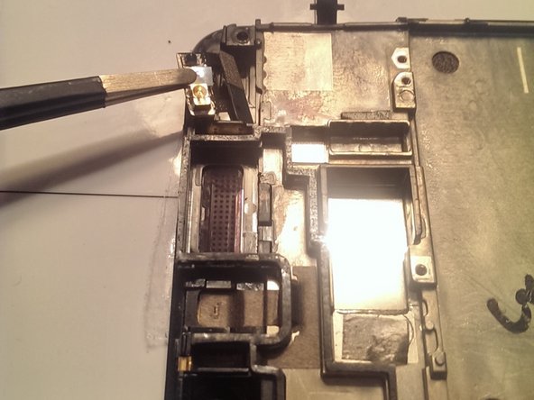

    19. HTC One Display Assembly Replacement, Plastic Piece: crwdns2935265:019crwdnd2935265:01crwdnd2935265:03crwdne2935265:0 HTC One Display Assembly Replacement, Plastic Piece: crwdns2935265:019crwdnd2935265:02crwdnd2935265:03crwdne2935265:0 HTC One Display Assembly Replacement, Plastic Piece: crwdns2935265:019crwdnd2935265:03crwdnd2935265:03crwdne2935265:0
      • This plastic piece goes directly over the screw hole. It falls out easily, but when removing and replacing it only goes back in place in one direction. The shape of the plastic piece makes it go into place in only one direction.

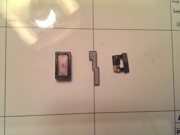

    20. HTC One Display Assembly Replacement, Removal of The Final Pieces: crwdns2935265:020crwdnd2935265:01crwdnd2935265:03crwdne2935265:0 HTC One Display Assembly Replacement, Removal of The Final Pieces: crwdns2935265:020crwdnd2935265:02crwdnd2935265:03crwdne2935265:0 HTC One Display Assembly Replacement, Removal of The Final Pieces: crwdns2935265:020crwdnd2935265:03crwdnd2935265:03crwdne2935265:0
      • Remove the earpiece by prying up with a sharp tweezer. It is held in place with adhesive and needs a little prying.
      • Remove the power button by Peeling away the small amount of tape holding it to the screen assembly.
      • Remove the plastic spacer that looks like a Tetris piece, it slides in and out easily and may fall out if not careful.
    21. HTC One Display Assembly Replacement, Reassembly: crwdns2935265:021crwdnd2935265:01crwdnd2935265:02crwdne2935265:0 HTC One Display Assembly Replacement, Reassembly: crwdns2935265:021crwdnd2935265:02crwdnd2935265:02crwdne2935265:0
      • Reassembly entails building everything onto the new screen assembly.
      • First transfer the earpiece, power button, and spacer onto the new screen assembly
      • Next replace the small logic board that contains the USB connector

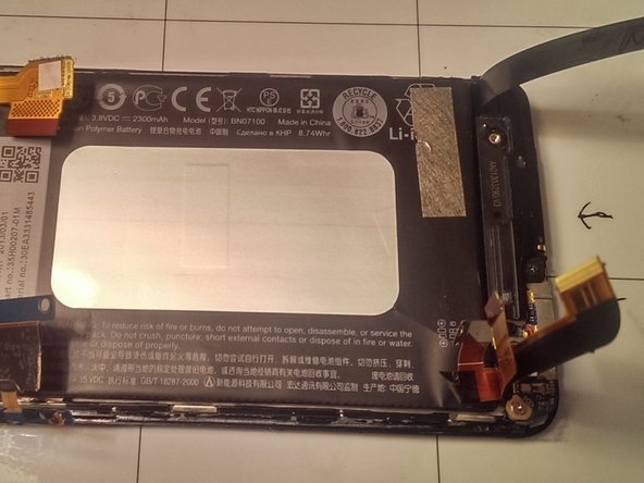

    22. HTC One Display Assembly Replacement, Battery Reassembly: crwdns2935265:022crwdnd2935265:01crwdnd2935265:02crwdne2935265:0 HTC One Display Assembly Replacement, Battery Reassembly: crwdns2935265:022crwdnd2935265:02crwdnd2935265:02crwdne2935265:0
      • Put down some double sided tape to hold the battery against the screen assembly
      • When putting the battery in place, make sure that the battery's flex cable is facing up and at the correct corner as seen in the photo so that it will be able to connect to the mother board in the later reassembly steps.
