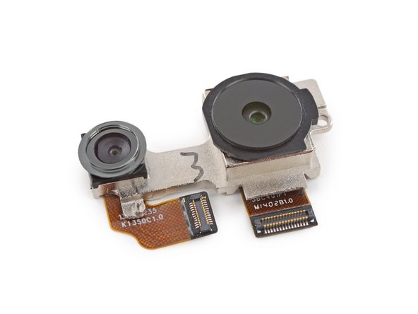

    • Chipworks found last year's "UltraPixel" cam to be a 4-megapixel affair. This revision likely has the same pixel count, but with larger pixels.
    • Much more interesting is the addition of this secondary rear camera, which in concert with the first enables all sorts of fancy image data manipulation, retroactive focusing, and special effects.

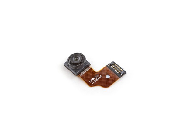

    • Not to be outdone, the intrepid selfie-cam gets a huge spec bump, leaping from last season's 2.1 megapixels to a whopping 5.0 MP (more than selfiesufficient).

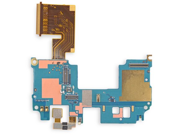

  14. HTC One (M8) Teardown: crwdns2935265:015crwdnd2935265:01crwdnd2935265:02crwdne2935265:0 HTC One (M8) Teardown: crwdns2935265:015crwdnd2935265:02crwdnd2935265:02crwdne2935265:0
    • Keeping each other company on the now-sparsely-populated daughterboard are a couple of remaining chips:
    • NXP 44701 NFC controller
    • Bosch Sensortec BMP280 pressure sensor
    • Qualcomm QFE1550 dynamic antenna matching tuner

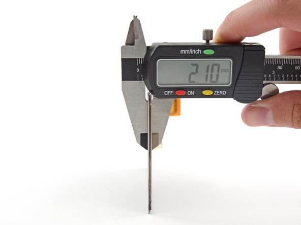

    • With all of the quality control stamps and signatures on the back of the 1080p display, we're reminded of a certain Macintosh we recently tore down.
    • To make a thin phone (9.4 mm), you need thin components. The fused LCD and digitizer measures little more than 2 mm.
