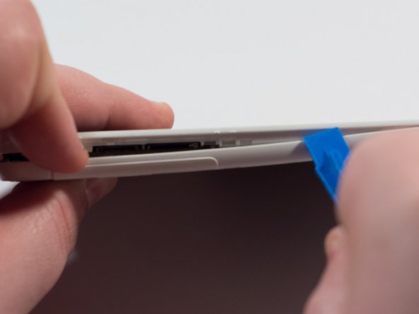

  3. HTC OPM9200 Upper Logic Board: crwdns2935265:03crwdnd2935265:01crwdnd2935265:02crwdne2935265:0 HTC OPM9200 Upper Logic Board: crwdns2935265:03crwdnd2935265:02crwdnd2935265:02crwdne2935265:0
    • Place a plastic opening tool along the seam of the front plate and back plate. Run the opening tool along the seam while prying slightly in order to pop the plastic clips away from the front plate.
    • Once one or two clips have popped away you may begin to use your free hand to apply additional pressure while continuing to apply prying pressure as well with the opening tool.
    • Apply constant but controlled pressure while separating the front from the back. Damage may occur if using excessive pressure while separating the plates along the seam.
  4. HTC OPM9200 Upper Logic Board: crwdns2935265:04crwdnd2935265:01crwdnd2935265:01crwdne2935265:0
    • Continue working your way around the seam between the two parts and eventually you will be able to separate the entirety of the backplate revealing the internals of the device.

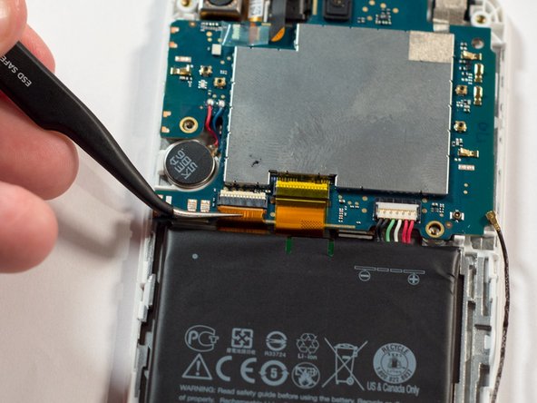

  5. HTC OPM9200 Upper Logic Board, Upper Logic Board: crwdns2935265:05crwdnd2935265:01crwdnd2935265:01crwdne2935265:0
    • Using the tweezers, remove the antenna connection. Grab the connector by the base and pull towards the head of the connector.
  6. HTC OPM9200 Upper Logic Board: crwdns2935265:06crwdnd2935265:01crwdnd2935265:02crwdne2935265:0 HTC OPM9200 Upper Logic Board: crwdns2935265:06crwdnd2935265:02crwdnd2935265:02crwdne2935265:0
    • Remove the tape that sits on top of the left connector.
    • Place the tweezers around the ribbon cable and apply even pressure away from the connector to disconnect the cable.

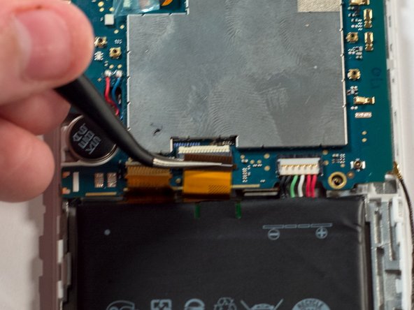

  7. HTC OPM9200 Upper Logic Board: crwdns2935265:07crwdnd2935265:01crwdnd2935265:02crwdne2935265:0 HTC OPM9200 Upper Logic Board: crwdns2935265:07crwdnd2935265:02crwdnd2935265:02crwdne2935265:0
    • Remove the tape that sits on top of the right connector.

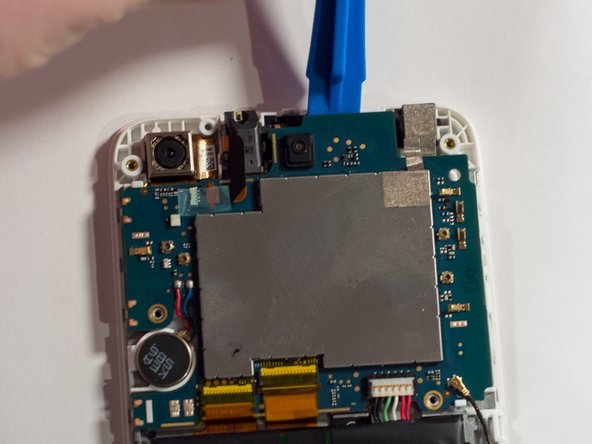

  10. HTC OPM9200 Upper Logic Board: crwdns2935265:010crwdnd2935265:01crwdnd2935265:02crwdne2935265:0 HTC OPM9200 Upper Logic Board: crwdns2935265:010crwdnd2935265:02crwdnd2935265:02crwdne2935265:0
    • Note the location of the plastic clips.
    • Place the plastic opening tool along the top of the upper logic board. Apply even gentle pressure to remove the logic board from the rest of the device.
