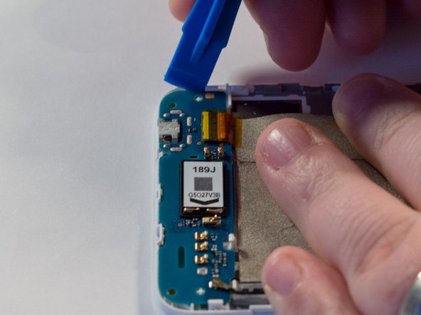

  9. HTC OPM9200 Digitizer & Display Replacement, Lower Logic Board Prereq: crwdns2935265:09crwdnd2935265:01crwdnd2935265:01crwdne2935265:0
    • Remove the antenna connector from the bottom logic board by using tweezers. Grasp the bottom of the metal connector and pull away towards the top of the connector.
    • The connector should come free easily if done correctly.
  10. HTC OPM9200 Digitizer & Display Replacement: crwdns2935265:010crwdnd2935265:01crwdnd2935265:01crwdne2935265:0
    • Remove the tape covering the connector that holds the ribbon cable to the lower logic board in place.
    • Use tweezers to pull the ribbon cable free of the connector. Pulling directly away from the connector apply even and constant pressure until the cable slides free.
  11. HTC OPM9200 Digitizer & Display Replacement: crwdns2935265:011crwdnd2935265:01crwdnd2935265:02crwdne2935265:0 HTC OPM9200 Digitizer & Display Replacement: crwdns2935265:011crwdnd2935265:02crwdnd2935265:02crwdne2935265:0
    • Note the position of the three plastic clips holding the lower logic board in place.
    • Place the plastic opening tool along one side and slowly begin to pry up. The board will flex slightly allowing it to pass by and free of the plastic clips.

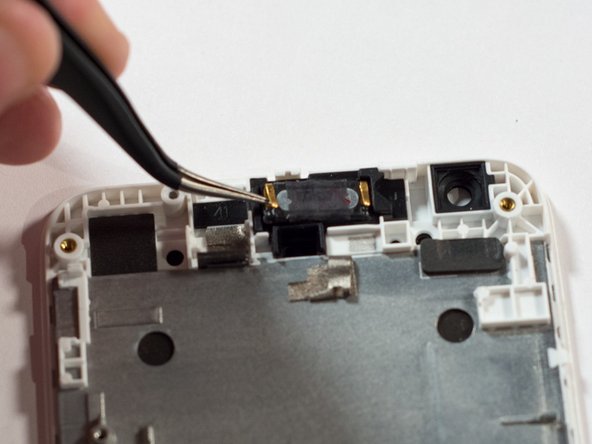

  18. HTC OPM9200 Digitizer & Display Replacement, Upper Speaker: crwdns2935265:018crwdnd2935265:01crwdnd2935265:02crwdne2935265:0 HTC OPM9200 Digitizer & Display Replacement, Upper Speaker: crwdns2935265:018crwdnd2935265:02crwdnd2935265:02crwdne2935265:0
    • Lift the tape securing the upper speaker.
    • Apply gentle pressure with the tweezers to dislodge the speaker and then lift away from the rest of the device.
