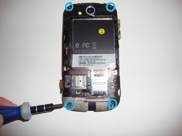

  4. HTC MyTouch 4G Motherboard Replacement, Removing Screws: crwdns2935265:04crwdnd2935265:01crwdnd2935265:01crwdne2935265:0
    • Remove the two T5x5mm Screws with the T5 Torx Screw driver.
    • Remove the one Phillips screw with the Phillips #00 Screwdriver.
  5. HTC MyTouch 4G Motherboard Replacement, Removing back case.: crwdns2935265:05crwdnd2935265:01crwdnd2935265:03crwdne2935265:0 HTC MyTouch 4G Motherboard Replacement, Removing back case.: crwdns2935265:05crwdnd2935265:02crwdnd2935265:03crwdne2935265:0 HTC MyTouch 4G Motherboard Replacement, Removing back case.: crwdns2935265:05crwdnd2935265:03crwdnd2935265:03crwdne2935265:0
    • Use the plastic opening tools to remove the back case.
    • There are four T5x5mm screws. Use the T5 Torx Screwdriver to remove them.

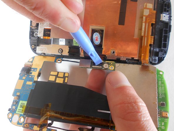

  10. HTC MyTouch 4G Motherboard Replacement: crwdns2935265:010crwdnd2935265:01crwdnd2935265:03crwdne2935265:0 HTC MyTouch 4G Motherboard Replacement: crwdns2935265:010crwdnd2935265:02crwdnd2935265:03crwdne2935265:0 HTC MyTouch 4G Motherboard Replacement: crwdns2935265:010crwdnd2935265:03crwdnd2935265:03crwdne2935265:0
    • Do not lift the Motherboard off the phone. The LCD Ribbon is still connected to it.
    • Lift the Motherboard towards the left to expose the LCD clamp connector.
    • Open the clamp connector of the LCD ribbon by carefully pulling it up with the plastic opening tools.
  11. HTC MyTouch 4G Motherboard Replacement: crwdns2935265:011crwdnd2935265:01crwdnd2935265:01crwdne2935265:0
    • The motherboard is now removed.
