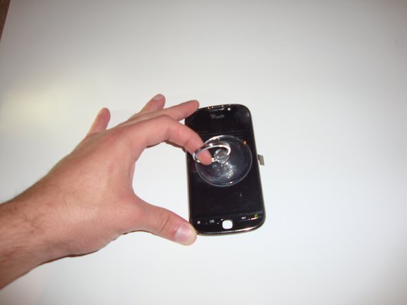

    1. HTC MyTouch 4G LCD Replacement, LCD: crwdns2935265:012crwdnd2935265:01crwdnd2935265:03crwdne2935265:0 HTC MyTouch 4G LCD Replacement, LCD: crwdns2935265:012crwdnd2935265:02crwdnd2935265:03crwdne2935265:0 HTC MyTouch 4G LCD Replacement, LCD: crwdns2935265:012crwdnd2935265:03crwdnd2935265:03crwdne2935265:0
      • Put the LCD side of the phone facing upward.
      • Use the iOpener to heat and loosen the adhesive up that is holding the digitizer in place.
      • Move the plastic opening tools along the outside edge of the digitizer to loosen it more and remove.

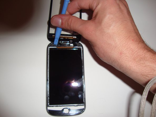

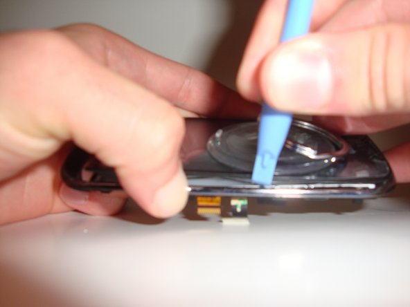

    2. HTC MyTouch 4G LCD Replacement: crwdns2935265:013crwdnd2935265:01crwdnd2935265:03crwdne2935265:0 HTC MyTouch 4G LCD Replacement: crwdns2935265:013crwdnd2935265:02crwdnd2935265:03crwdne2935265:0 HTC MyTouch 4G LCD Replacement: crwdns2935265:013crwdnd2935265:03crwdnd2935265:03crwdne2935265:0
      • Do not take the digitizer fully off as it is still connected by the ribbon.

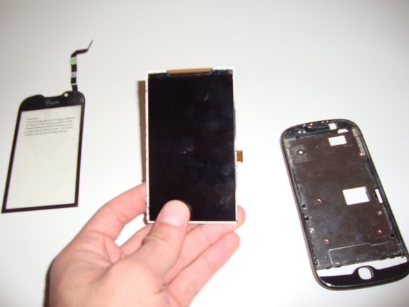

      • Use the iOpener tool to heat up the LCD adhesive.
      • Using the iOpener kit and the plastic opening tools again, remove the LCD. The LCD is now ready to be replaced. Make sure to have more adhesive that usually comes with the replacement to make sure the LCD and digitizer will be secure.
