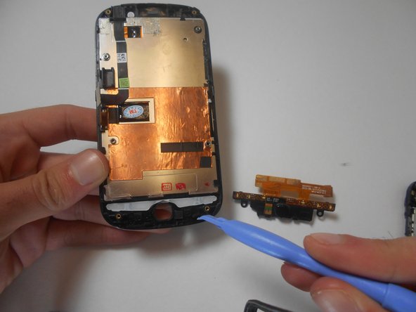

    8. HTC MyTouch 4G Button Replacement: crwdns2935265:011crwdnd2935265:01crwdnd2935265:01crwdne2935265:0
      • The motherboard is now removed.
    1. HTC MyTouch 4G Button Replacement, Button: crwdns2935265:012crwdnd2935265:01crwdnd2935265:02crwdne2935265:0 HTC MyTouch 4G Button Replacement, Button: crwdns2935265:012crwdnd2935265:02crwdnd2935265:02crwdne2935265:0
      • After removing the motherboard from the phone, the button bar is exposed and easily replaced.
      • Use the plastic opening tools to remove the button bar and replace it with the new one.
