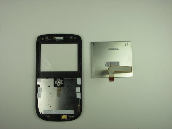

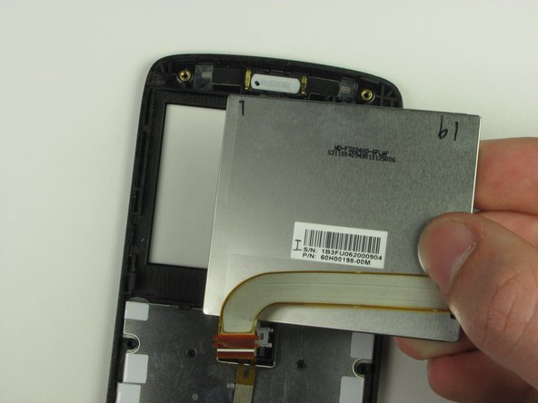

    1. HTC Maple 100 LCD Screen Replacement, LCD Screen: crwdns2935265:013crwdnd2935265:01crwdnd2935265:03crwdne2935265:0 HTC Maple 100 LCD Screen Replacement, LCD Screen: crwdns2935265:013crwdnd2935265:02crwdnd2935265:03crwdne2935265:0 HTC Maple 100 LCD Screen Replacement, LCD Screen: crwdns2935265:013crwdnd2935265:03crwdnd2935265:03crwdne2935265:0
      • Pry the LCD screen out by using the plastic opening tool or your fingers.
