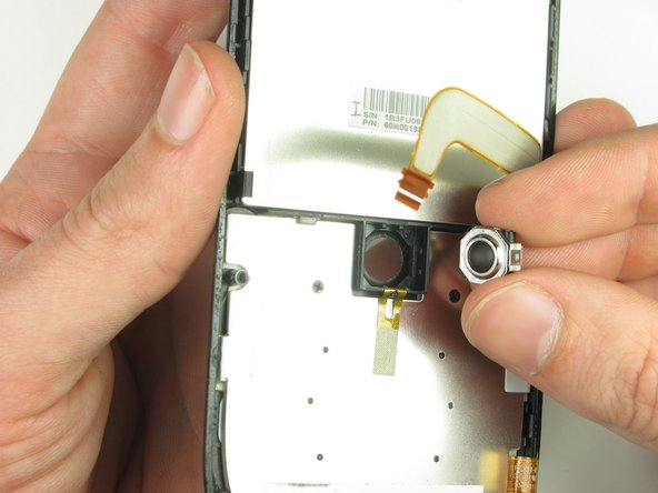

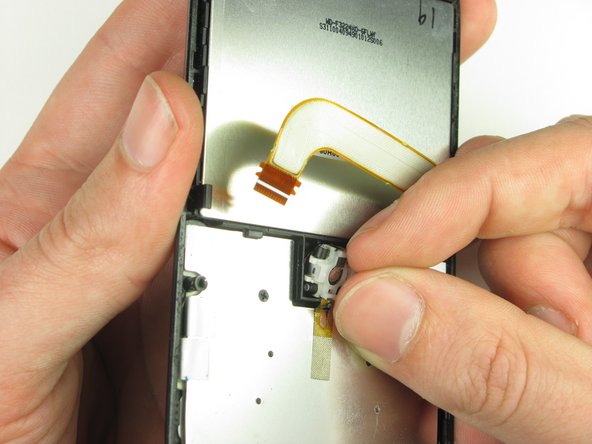

    1. HTC Maple 100 Keyboard Replacement, Trackball: crwdns2935265:013crwdnd2935265:01crwdnd2935265:03crwdne2935265:0 HTC Maple 100 Keyboard Replacement, Trackball: crwdns2935265:013crwdnd2935265:02crwdnd2935265:03crwdne2935265:0 HTC Maple 100 Keyboard Replacement, Trackball: crwdns2935265:013crwdnd2935265:03crwdnd2935265:03crwdne2935265:0
      • Using your fingers, gently pull the trackball out.

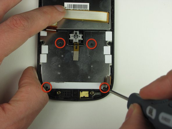

    1. HTC Maple 100 Keyboard Replacement, Keyboard: crwdns2935265:014crwdnd2935265:01crwdnd2935265:02crwdne2935265:0 HTC Maple 100 Keyboard Replacement, Keyboard: crwdns2935265:014crwdnd2935265:02crwdnd2935265:02crwdne2935265:0
      • Remove the four 1.9 mm Phillips #00 screws.

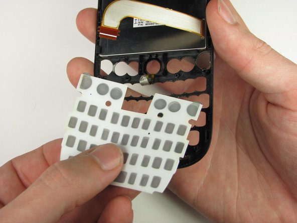

    4. HTC Maple 100 Keyboard Replacement: crwdns2935265:017crwdnd2935265:01crwdnd2935265:02crwdne2935265:0 HTC Maple 100 Keyboard Replacement: crwdns2935265:017crwdnd2935265:02crwdnd2935265:02crwdne2935265:0
      • Remove the keys carefully.
