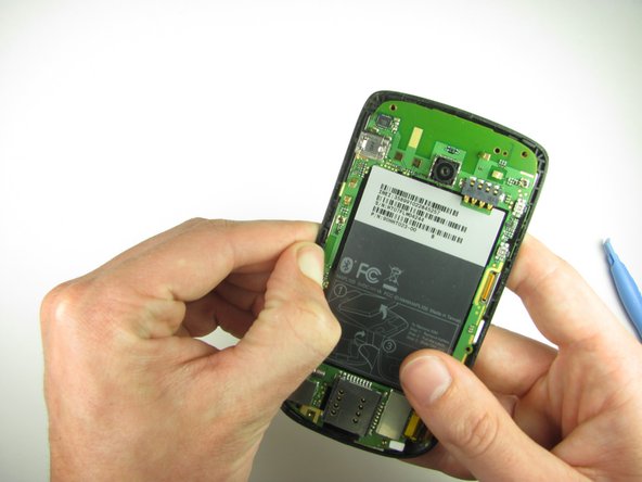

    • First remove the back cover of your phone to expose the battery.
  2. HTC Maple 100 Internal Ear Speaker Replacement: crwdns2935265:02crwdnd2935265:01crwdnd2935265:01crwdne2935265:0
    • Turn the phone over.
    • Push forward on the battery with your thumb.
  3. HTC Maple 100 Internal Ear Speaker Replacement: crwdns2935265:03crwdnd2935265:01crwdnd2935265:02crwdne2935265:0 HTC Maple 100 Internal Ear Speaker Replacement: crwdns2935265:03crwdnd2935265:02crwdnd2935265:02crwdne2935265:0
    • Take the battery out by lifting it upwards.
    • When reassembling, make sure that the battery contacts match up.

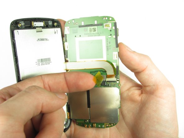

  9. HTC Maple 100 Internal Ear Speaker Replacement: crwdns2935265:09crwdnd2935265:01crwdnd2935265:02crwdne2935265:0 HTC Maple 100 Internal Ear Speaker Replacement: crwdns2935265:09crwdnd2935265:02crwdnd2935265:02crwdne2935265:0
    • Peel off the yellow piece of tape from the phone.
  10. HTC Maple 100 Internal Ear Speaker Replacement: crwdns2935265:010crwdnd2935265:01crwdnd2935265:03crwdne2935265:0 HTC Maple 100 Internal Ear Speaker Replacement: crwdns2935265:010crwdnd2935265:02crwdnd2935265:03crwdne2935265:0 HTC Maple 100 Internal Ear Speaker Replacement: crwdns2935265:010crwdnd2935265:03crwdnd2935265:03crwdne2935265:0
    • Flip up the retaining flap with your fingernail or a plastic opening tool.
    • Pull on the ribbon cable gently with your fingers.
  11. HTC Maple 100 Internal Ear Speaker Replacement: crwdns2935265:011crwdnd2935265:01crwdnd2935265:02crwdne2935265:0 HTC Maple 100 Internal Ear Speaker Replacement: crwdns2935265:011crwdnd2935265:02crwdnd2935265:02crwdne2935265:0
    • Split apart the motherboard and front panel.
    • Remove the other yellow piece of tape off of the end of the ribbon cable.
  12. HTC Maple 100 Internal Ear Speaker Replacement: crwdns2935265:012crwdnd2935265:01crwdnd2935265:02crwdne2935265:0 HTC Maple 100 Internal Ear Speaker Replacement: crwdns2935265:012crwdnd2935265:02crwdnd2935265:02crwdne2935265:0
    • Gently pull on the ribbon cable to separate the motherboard.

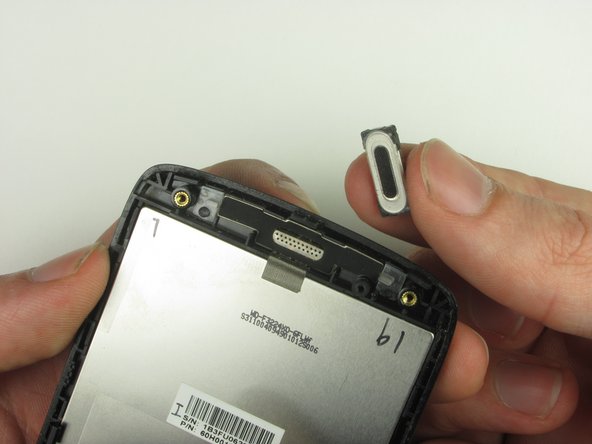

  13. HTC Maple 100 Internal Ear Speaker Replacement, Internal Ear Speaker: crwdns2935265:013crwdnd2935265:01crwdnd2935265:01crwdne2935265:0
    • Locate the internal speaker at the top center of the phone.
  14. HTC Maple 100 Internal Ear Speaker Replacement: crwdns2935265:014crwdnd2935265:01crwdnd2935265:02crwdne2935265:0 HTC Maple 100 Internal Ear Speaker Replacement: crwdns2935265:014crwdnd2935265:02crwdnd2935265:02crwdne2935265:0
    • Using the plastic opening tool, carefully pry out the internal speaker.
