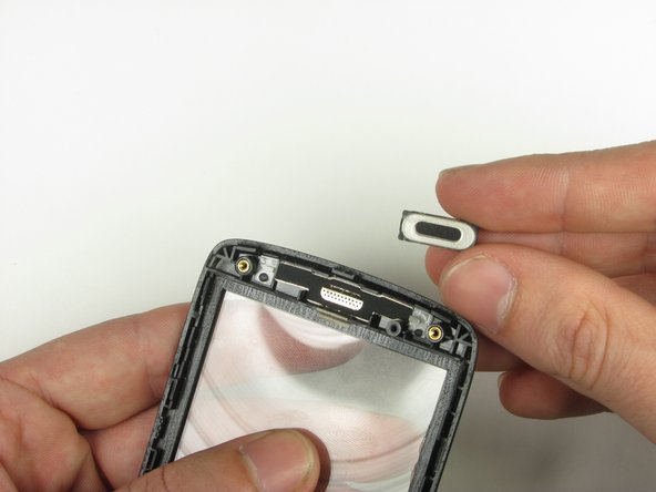

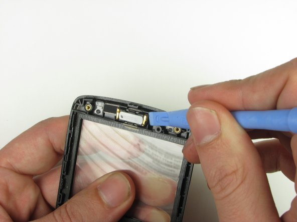

    2. HTC Maple 100 Front Panel Replacement: crwdns2935265:018crwdnd2935265:01crwdnd2935265:03crwdne2935265:0 HTC Maple 100 Front Panel Replacement: crwdns2935265:018crwdnd2935265:02crwdnd2935265:03crwdne2935265:0 HTC Maple 100 Front Panel Replacement: crwdns2935265:018crwdnd2935265:03crwdnd2935265:03crwdne2935265:0
      • Use the Plastic Opening Tool to remove the internal ear speaker.
