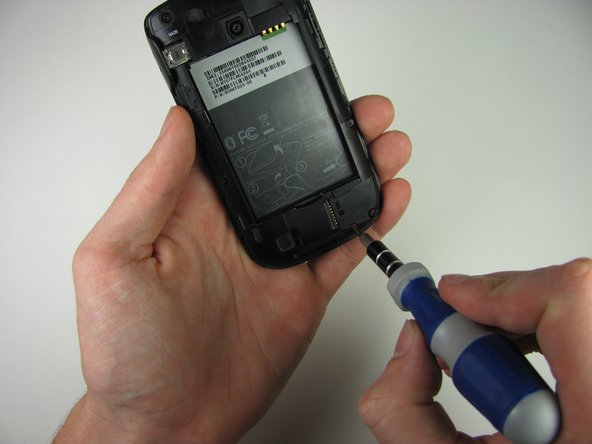

    1. HTC Maple 100 External Speaker Replacement, Back Panel: crwdns2935265:04crwdnd2935265:01crwdnd2935265:02crwdne2935265:0 HTC Maple 100 External Speaker Replacement, Back Panel: crwdns2935265:04crwdnd2935265:02crwdnd2935265:02crwdne2935265:0
      • Remove the four 4.9mm T6 Torx screws that secure the back panel to the rest of the phone.
    2. HTC Maple 100 External Speaker Replacement: crwdns2935265:05crwdnd2935265:01crwdnd2935265:01crwdne2935265:0
      • Remove the two 4.3mm Phillips #00 screws that secure the back panel to the rest of the phone.

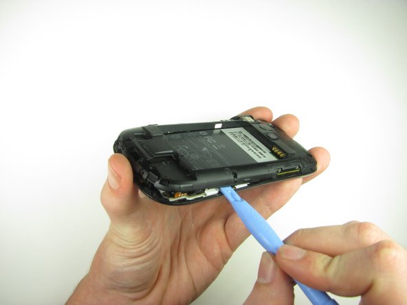

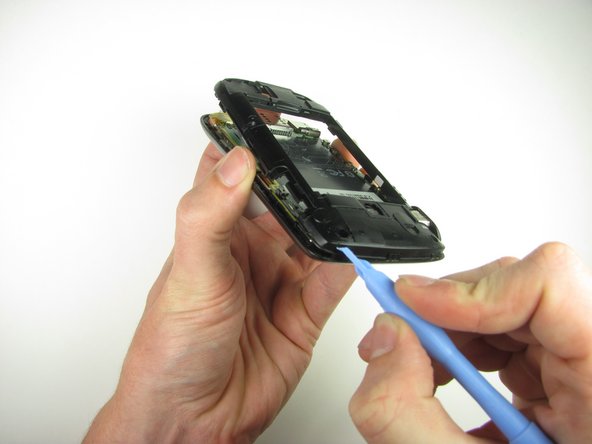

    3. HTC Maple 100 External Speaker Replacement: crwdns2935265:06crwdnd2935265:01crwdnd2935265:03crwdne2935265:0 HTC Maple 100 External Speaker Replacement: crwdns2935265:06crwdnd2935265:02crwdnd2935265:03crwdne2935265:0 HTC Maple 100 External Speaker Replacement: crwdns2935265:06crwdnd2935265:03crwdnd2935265:03crwdne2935265:0
      • Insert the plastic opening tool along the seams at different points to it pry the clips off.
      • This may require a bit of force. The USB port cover may fall off in this step.

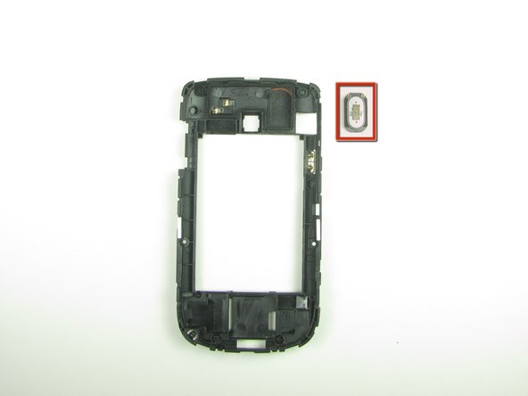

    1. HTC Maple 100 External Speaker Replacement, External Speaker: crwdns2935265:07crwdnd2935265:01crwdnd2935265:02crwdne2935265:0 HTC Maple 100 External Speaker Replacement, External Speaker: crwdns2935265:07crwdnd2935265:02crwdnd2935265:02crwdne2935265:0
      • Using the plastic opening tool, pry the external speaker out of the back panel.
