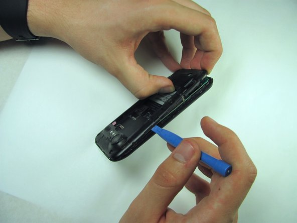

    1. HTC Incredible 2 Volume Button Replacement, Mid Panel: crwdns2935265:05crwdnd2935265:01crwdnd2935265:01crwdne2935265:0
      • Remove the seven 1.42 mm Torx T5 screws
    2. HTC Incredible 2 Volume Button Replacement: crwdns2935265:06crwdnd2935265:01crwdnd2935265:02crwdne2935265:0 HTC Incredible 2 Volume Button Replacement: crwdns2935265:06crwdnd2935265:02crwdnd2935265:02crwdne2935265:0
      • Use a plastic opening tool to run along the phone's side and lever mid panel upward.
      • Apply minimal pressure as the mid panel is very delicate.

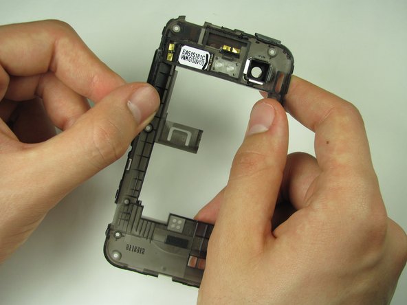

    3. HTC Incredible 2 Volume Button Replacement: crwdns2935265:07crwdnd2935265:01crwdnd2935265:01crwdne2935265:0
      • Gently grasp and carefully lift mid panel up and away from the device with your fingers.

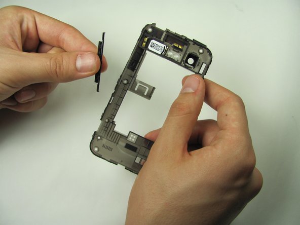

    1. HTC Incredible 2 Volume Button Replacement, Volume Button: crwdns2935265:08crwdnd2935265:01crwdnd2935265:03crwdne2935265:0 HTC Incredible 2 Volume Button Replacement, Volume Button: crwdns2935265:08crwdnd2935265:02crwdnd2935265:03crwdne2935265:0 HTC Incredible 2 Volume Button Replacement, Volume Button: crwdns2935265:08crwdnd2935265:03crwdnd2935265:03crwdne2935265:0
      • Firmly grasp the volume button from the mid panel on the clip side
      • Gently lift the button upwards and remove it
