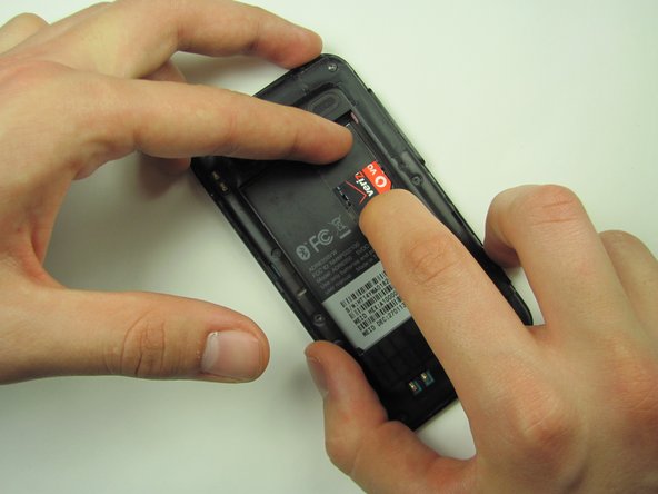

    1. HTC Incredible 2 SIM Card Replacement, SIM Card: crwdns2935265:05crwdnd2935265:01crwdnd2935265:02crwdne2935265:0 HTC Incredible 2 SIM Card Replacement, SIM Card: crwdns2935265:05crwdnd2935265:02crwdnd2935265:02crwdne2935265:0
      • Apply pressure with your fingertip to the pressure clip beneath the SIM card.
      • While keeping pressure on the clip, use another finger to gently slide the SIM card down over the clip.
    2. HTC Incredible 2 SIM Card Replacement: crwdns2935265:06crwdnd2935265:01crwdnd2935265:02crwdne2935265:0 HTC Incredible 2 SIM Card Replacement: crwdns2935265:06crwdnd2935265:02crwdnd2935265:02crwdne2935265:0
      • Keep sliding SIM card until completely free from holding apparatus. Now remove the SIM card.
