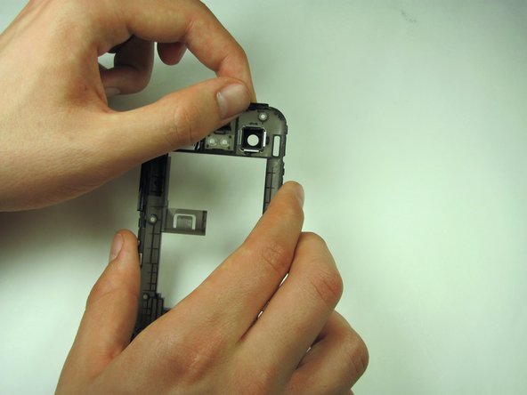

    3. HTC Incredible 2 Power Button Replacement: crwdns2935265:09crwdnd2935265:01crwdnd2935265:01crwdne2935265:0
      • Gently grasp and carefully lift mid panel up and away from the device with your fingers.

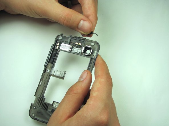

    1. HTC Incredible 2 Power Button Replacement, Power Button: crwdns2935265:010crwdnd2935265:01crwdnd2935265:03crwdne2935265:0 HTC Incredible 2 Power Button Replacement, Power Button: crwdns2935265:010crwdnd2935265:02crwdnd2935265:03crwdne2935265:0 HTC Incredible 2 Power Button Replacement, Power Button: crwdns2935265:010crwdnd2935265:03crwdnd2935265:03crwdne2935265:0
      • Firmly grasp the power button, located on the upper right corner of the mid panel, and gently lift it up and off the mid panel.
