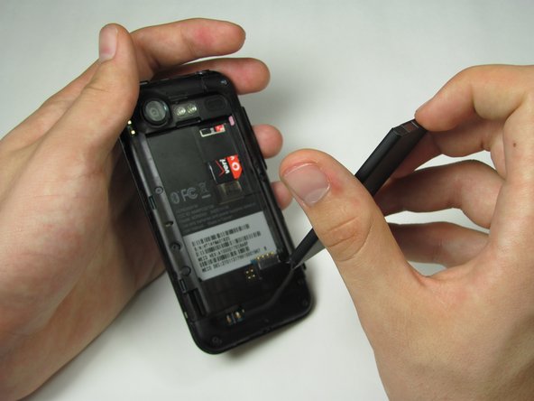

    1. HTC Incredible 2 Battery Replacement, Battery: crwdns2935265:03crwdnd2935265:01crwdnd2935265:01crwdne2935265:0
      • Press your fingernail into the slot between the battery and the rear inner frame, located between the battery and LED lights.
      • Use a penny or dime if you can't use your fingernail.
    2. HTC Incredible 2 Battery Replacement: crwdns2935265:04crwdnd2935265:01crwdnd2935265:02crwdne2935265:0 HTC Incredible 2 Battery Replacement: crwdns2935265:04crwdnd2935265:02crwdnd2935265:02crwdne2935265:0
      • Gently lever the battery up and away from the lights.
      • Lift the top of the battery up and remove the battery from the rear inner frame.
