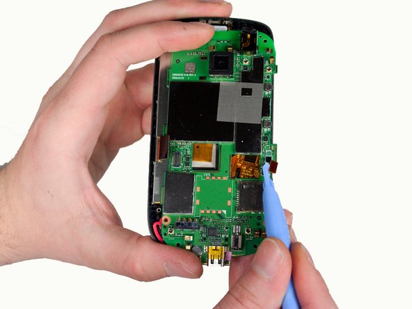

  3. HTC Hero Trackball Replacement: crwdns2935265:03crwdnd2935265:01crwdnd2935265:01crwdne2935265:0
    • Gently depress and release the small plastic tabs around the rim in the front enclosure, highlighted here.
    • It is best to start with the tab found on the top center of the phone, as it is easiest to locate.
  4. HTC Hero Trackball Replacement: crwdns2935265:04crwdnd2935265:01crwdnd2935265:02crwdne2935265:0 HTC Hero Trackball Replacement: crwdns2935265:04crwdnd2935265:02crwdnd2935265:02crwdne2935265:0
    • Carefully separate the front and back enclosures once all of the clips have been disengaged.
    • Be sure to not separate too quickly or you risk breaking an attached tab.

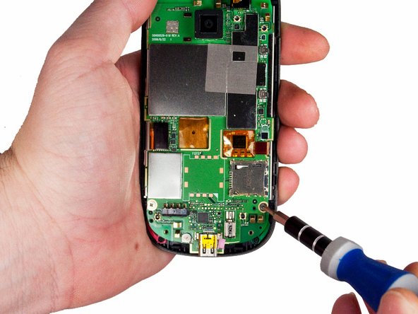

  5. HTC Hero Trackball Replacement, Trackball: crwdns2935265:05crwdnd2935265:01crwdnd2935265:02crwdne2935265:0 HTC Hero Trackball Replacement, Trackball: crwdns2935265:05crwdnd2935265:02crwdnd2935265:02crwdne2935265:0
    • Remove the two screws near the bottom of the motherboard with a Phillips head screwdriver.

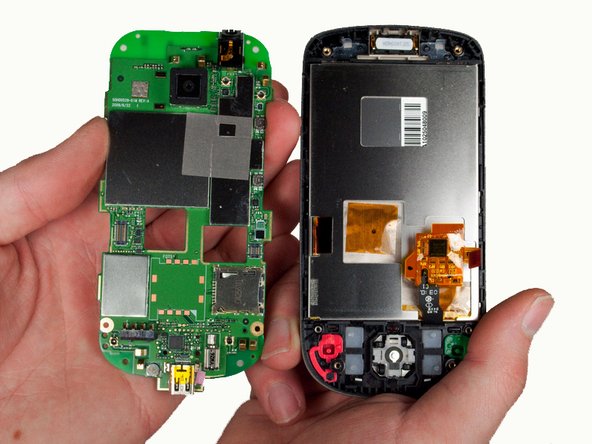

  7. HTC Hero Trackball Replacement: crwdns2935265:07crwdnd2935265:01crwdnd2935265:02crwdne2935265:0 HTC Hero Trackball Replacement: crwdns2935265:07crwdnd2935265:02crwdnd2935265:02crwdne2935265:0
    • Remove the motherboard from within the front enclosure.
    • Be careful when pulling the ribbons off the motherboard as they may rip or break.

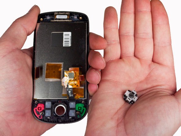

  8. HTC Hero Trackball Replacement: crwdns2935265:08crwdnd2935265:01crwdnd2935265:02crwdne2935265:0 HTC Hero Trackball Replacement: crwdns2935265:08crwdnd2935265:02crwdnd2935265:02crwdne2935265:0
    • Tilt the inside of the front enclosure towards your cupped palm to remove the trackball and it's enclosure will fall out.

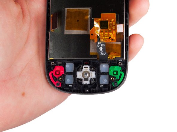

  9. HTC Hero Trackball Replacement: crwdns2935265:09crwdnd2935265:01crwdnd2935265:03crwdne2935265:0 HTC Hero Trackball Replacement: crwdns2935265:09crwdnd2935265:02crwdnd2935265:03crwdne2935265:0 HTC Hero Trackball Replacement: crwdns2935265:09crwdnd2935265:03crwdnd2935265:03crwdne2935265:0
    • Position the phone off of the edge of the table and insert the replacement part by inserting the bevel then the trackball into the hole.
    • Make sure the two plastic pins on the trackball bevel are oriented horizontally.
