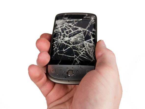

HTC Hero Touch Screen Digitizer Replacement

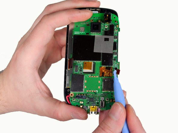

      • Gently release the two ribbon cables using a plastic opening tool by prying up the pop connectors used to attach the ribbon cables to the motherboard.
    2. HTC Hero Touch Screen Digitizer Replacement: crwdns2935265:06crwdnd2935265:01crwdnd2935265:02crwdne2935265:0 HTC Hero Touch Screen Digitizer Replacement: crwdns2935265:06crwdnd2935265:02crwdnd2935265:02crwdne2935265:0

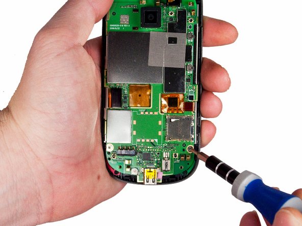

      • Remove the two screws located at the bottom left and right of the motherboard using a small Phillips screwdriver.

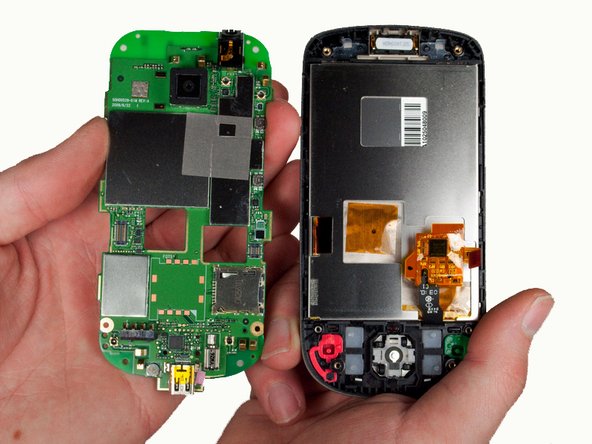

    3. HTC Hero Touch Screen Digitizer Replacement: crwdns2935265:07crwdnd2935265:01crwdnd2935265:02crwdne2935265:0 HTC Hero Touch Screen Digitizer Replacement: crwdns2935265:07crwdnd2935265:02crwdnd2935265:02crwdne2935265:0
      • Gently lift the motherboard out of the front enclosure once the screws are removed.

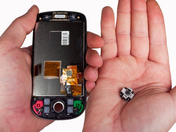

      • Remove the trackball and its enclosure by turning the phone over into your cupped hand and allowing the trackball and enclosure to fall out.

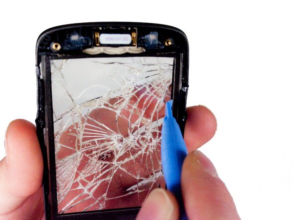

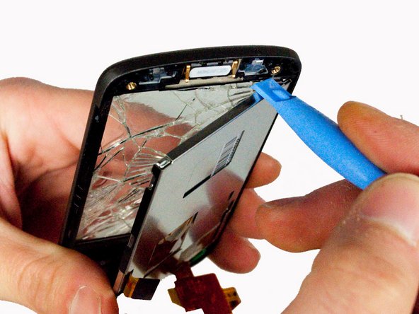

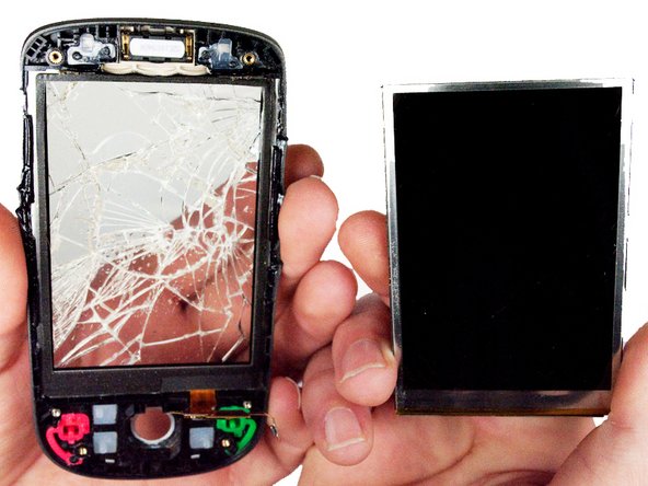

      • Gently pry out the LCD screen from the top left side of the enclosure using a plastic tool, as illustrated.
    6. HTC Hero Touch Screen Digitizer Replacement: crwdns2935265:010crwdnd2935265:01crwdnd2935265:02crwdne2935265:0 HTC Hero Touch Screen Digitizer Replacement: crwdns2935265:010crwdnd2935265:02crwdnd2935265:02crwdne2935265:0
      • Using a plastic opening tool, gently pry the glass from the frame by inserting the flat end between the glass and the frame from the inside of the phone.
      • Follow the edges of the glass to ensure that all the adhesive has been released.

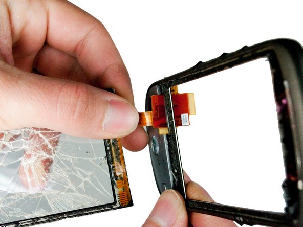

      • Be careful to remove the glass slowly. The ribbon cable that connects to the glass is routed through the plastic frame at the bottom.
    8. HTC Hero Touch Screen Digitizer Replacement: crwdns2935265:012crwdnd2935265:01crwdnd2935265:03crwdne2935265:0 HTC Hero Touch Screen Digitizer Replacement: crwdns2935265:012crwdnd2935265:02crwdnd2935265:03crwdne2935265:0 HTC Hero Touch Screen Digitizer Replacement: crwdns2935265:012crwdnd2935265:03crwdnd2935265:03crwdne2935265:0
      • Carefully feed the ribbon cable through the slot in the plastic frame.
