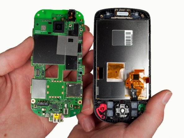

    4. HTC Hero Motherboard Replacement: crwdns2935265:04crwdnd2935265:01crwdnd2935265:02crwdne2935265:0 HTC Hero Motherboard Replacement: crwdns2935265:04crwdnd2935265:02crwdnd2935265:02crwdne2935265:0
      • Carefully separate the front and back enclosures once all of the clips have been disengaged.
      • Be sure to not separate too quickly or you risk breaking an attached tab.

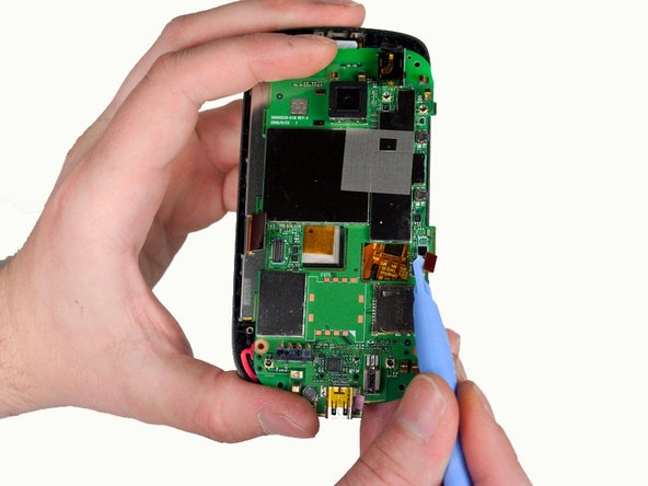

    1. HTC Hero Motherboard Replacement, Motherboard: crwdns2935265:05crwdnd2935265:01crwdnd2935265:02crwdne2935265:0 HTC Hero Motherboard Replacement, Motherboard: crwdns2935265:05crwdnd2935265:02crwdnd2935265:02crwdne2935265:0
      • Release the two ribbon cables using a plastic opening tool.
      • Gently pry up the pop connectors used to attach the ribbon cables to the motherboard.

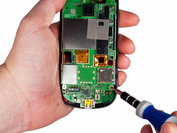

    2. HTC Hero Motherboard Replacement: crwdns2935265:06crwdnd2935265:01crwdnd2935265:02crwdne2935265:0 HTC Hero Motherboard Replacement: crwdns2935265:06crwdnd2935265:02crwdnd2935265:02crwdne2935265:0
      • Remove the two screws located at the bottom left and right of the motherboard using a small Phillips screwdriver.
    3. HTC Hero Motherboard Replacement: crwdns2935265:07crwdnd2935265:01crwdnd2935265:02crwdne2935265:0 HTC Hero Motherboard Replacement: crwdns2935265:07crwdnd2935265:02crwdnd2935265:02crwdne2935265:0
      • Gently lift the motherboard out of the front enclosure once the screws are removed.
