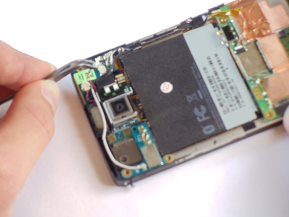

  8. HTC HD2 Screen Replacement, Camera: crwdns2935265:08crwdnd2935265:01crwdnd2935265:03crwdne2935265:0 HTC HD2 Screen Replacement, Camera: crwdns2935265:08crwdnd2935265:02crwdnd2935265:03crwdne2935265:0 HTC HD2 Screen Replacement, Camera: crwdns2935265:08crwdnd2935265:03crwdnd2935265:03crwdne2935265:0
    • Disconnect the flash cable from its socket in the bottom of the motherboard.
    • Carefully pull the cable from its groove in the frame, working your way back to the camera.
  9. HTC HD2 Screen Replacement: crwdns2935265:09crwdnd2935265:01crwdnd2935265:03crwdne2935265:0 HTC HD2 Screen Replacement: crwdns2935265:09crwdnd2935265:02crwdnd2935265:03crwdne2935265:0 HTC HD2 Screen Replacement: crwdns2935265:09crwdnd2935265:03crwdnd2935265:03crwdne2935265:0
    • Pull the camera flash and cover off of the board.
    • You may need to peel back the sticker that sits behind the battery.
    • Work carefully. Excessive force can damage the camera or motherboard.
  10. HTC HD2 Screen Replacement: crwdns2935265:010crwdnd2935265:01crwdnd2935265:01crwdne2935265:0
    • Around the camera is a thin shielding. Remove it with tweezers.
    • Using tweezers, remove the primary camera.

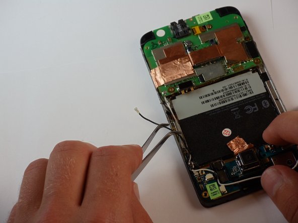

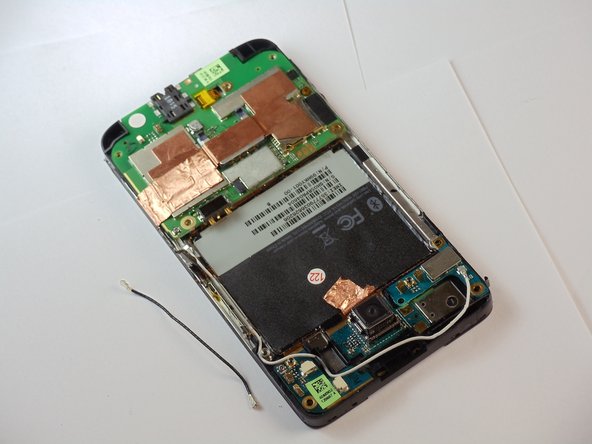

    • Now locate the coaxial bluetooth cable that connects the top and bottom boards of the phone.
    • Use tweezers to pop both ends of the cable from the boards and remove it completely.

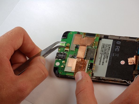

  15. HTC HD2 Screen Replacement: crwdns2935265:015crwdnd2935265:01crwdnd2935265:03crwdne2935265:0 HTC HD2 Screen Replacement: crwdns2935265:015crwdnd2935265:02crwdnd2935265:03crwdne2935265:0 HTC HD2 Screen Replacement: crwdns2935265:015crwdnd2935265:03crwdnd2935265:03crwdne2935265:0
    • Now find the AP FPC, one of the smallest connectors on the bottom board.
    • Pop the small black tab up using tweezers, then unplug the cable.

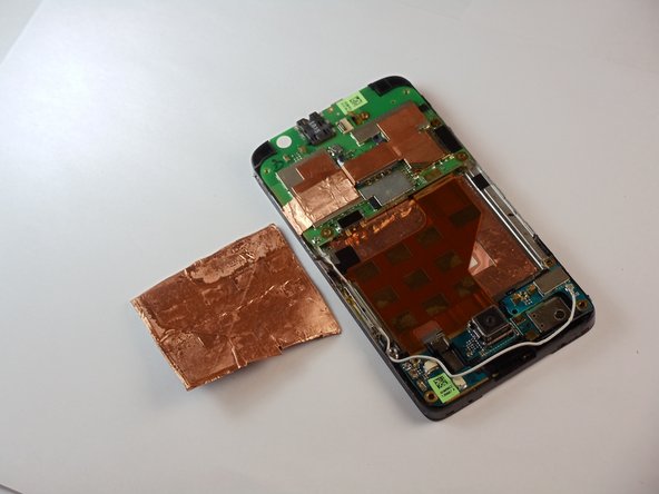

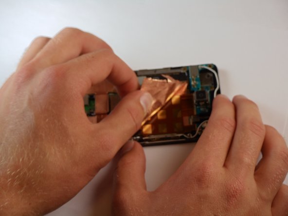

  16. HTC HD2 Screen Replacement: crwdns2935265:016crwdnd2935265:01crwdnd2935265:03crwdne2935265:0 HTC HD2 Screen Replacement: crwdns2935265:016crwdnd2935265:02crwdnd2935265:03crwdne2935265:0 HTC HD2 Screen Replacement: crwdns2935265:016crwdnd2935265:03crwdnd2935265:03crwdne2935265:0
    • This step is pretty much irreversible, so do not do this unless you absolutely have to.
    • Remember peeling back part of that big sticker in the middle? Now you get to take it all the way off.
    • This may take some time, and the use of the tweezers, but keep at it until the whole sticker is off.

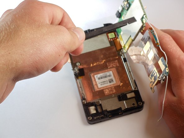

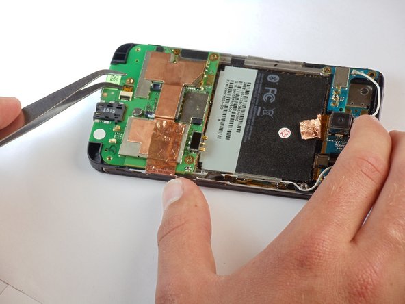

  19. HTC HD2 Screen Replacement: crwdns2935265:019crwdnd2935265:01crwdnd2935265:03crwdne2935265:0 HTC HD2 Screen Replacement: crwdns2935265:019crwdnd2935265:02crwdnd2935265:03crwdne2935265:0 HTC HD2 Screen Replacement: crwdns2935265:019crwdnd2935265:03crwdnd2935265:03crwdne2935265:0
    • Using a spudger, begin to pry the copper colored board in the middle away from the phone to loosen it.
    • Also pry the small piece that runs under where the volume selector is on the full phone.

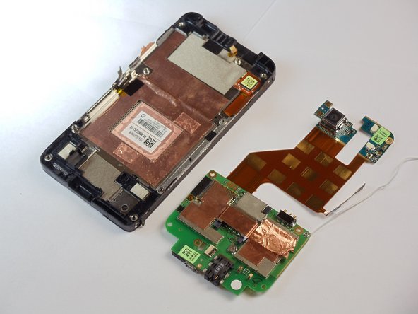

  20. HTC HD2 Screen Replacement: crwdns2935265:020crwdnd2935265:01crwdnd2935265:03crwdne2935265:0 HTC HD2 Screen Replacement: crwdns2935265:020crwdnd2935265:02crwdnd2935265:03crwdne2935265:0 HTC HD2 Screen Replacement: crwdns2935265:020crwdnd2935265:03crwdnd2935265:03crwdne2935265:0
    • There is a connecter cable under the main board, so do not pull it all the way off right away.
    • Gently pop both the top and bottom boards off of the phone, and turn them over to the left

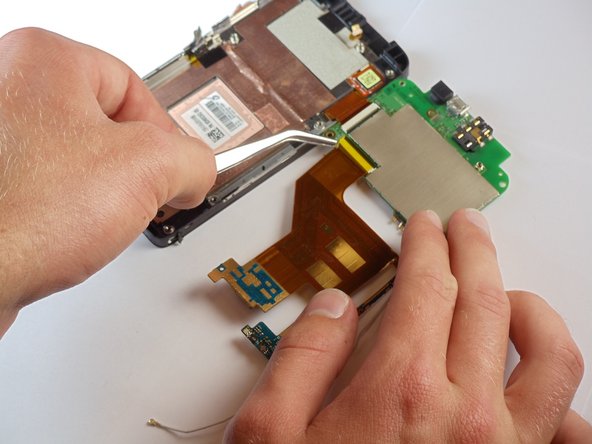

  21. HTC HD2 Screen Replacement: crwdns2935265:021crwdnd2935265:01crwdnd2935265:02crwdne2935265:0 HTC HD2 Screen Replacement: crwdns2935265:021crwdnd2935265:02crwdnd2935265:02crwdne2935265:0
    • With the back of the main board exposed, flip up the little brown lever at the end of the connector and unplug the final cable that connects it to the main board.

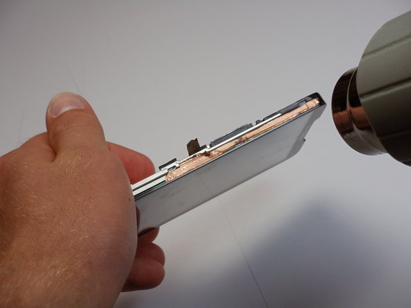

    • Caution: If your screen wasn't already cracked, it is very easy to do so in the next few steps. Proceed very carefully.
    • This step could take several minutes of heating.
    • Use a heat gun or hair dryer to soften the adhesive between the screen and the chassis
  23. HTC HD2 Screen Replacement: crwdns2935265:023crwdnd2935265:01crwdnd2935265:03crwdne2935265:0 HTC HD2 Screen Replacement: crwdns2935265:023crwdnd2935265:02crwdnd2935265:03crwdne2935265:0 HTC HD2 Screen Replacement: crwdns2935265:023crwdnd2935265:03crwdnd2935265:03crwdne2935265:0

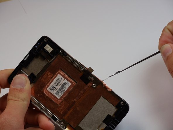

    • Once heating is done, carfully peel the covering along the sides of the phone away.
  24. HTC HD2 Screen Replacement: crwdns2935265:024crwdnd2935265:01crwdnd2935265:03crwdne2935265:0 HTC HD2 Screen Replacement: crwdns2935265:024crwdnd2935265:02crwdnd2935265:03crwdne2935265:0 HTC HD2 Screen Replacement: crwdns2935265:024crwdnd2935265:03crwdnd2935265:03crwdne2935265:0

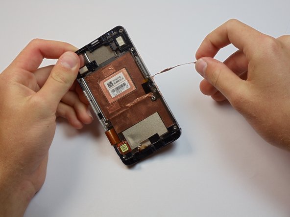

    • insert the spudger into the top closer to the back of the phone and slide along to fully disengage the adhesive. Do this for both sides.
    • Caution. The digitizer is firmly glued to LCD glass screen. Look closely to make sure you separate the digitizer from LCD panel and not part of LCD panel
