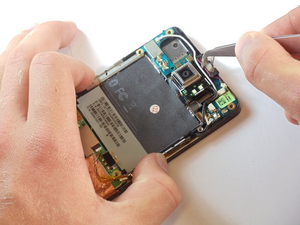

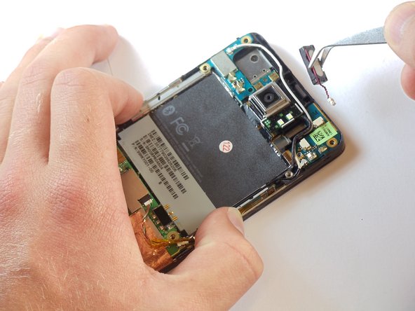

  5. HTC HD2 Earpiece Speaker Replacement, Earpiece Speaker: crwdns2935265:05crwdnd2935265:01crwdnd2935265:03crwdne2935265:0 HTC HD2 Earpiece Speaker Replacement, Earpiece Speaker: crwdns2935265:05crwdnd2935265:02crwdnd2935265:03crwdne2935265:0 HTC HD2 Earpiece Speaker Replacement, Earpiece Speaker: crwdns2935265:05crwdnd2935265:03crwdnd2935265:03crwdne2935265:0
    • Disconnect the small speaker cable from its socket on the motherboard.
    • Remove the earpiece speaker from the phone.
