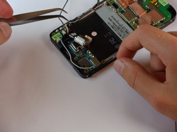

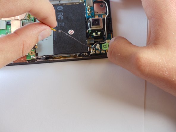

    1. HTC HD2 Camera Replacement, Camera: crwdns2935265:05crwdnd2935265:01crwdnd2935265:03crwdne2935265:0 HTC HD2 Camera Replacement, Camera: crwdns2935265:05crwdnd2935265:02crwdnd2935265:03crwdne2935265:0 HTC HD2 Camera Replacement, Camera: crwdns2935265:05crwdnd2935265:03crwdnd2935265:03crwdne2935265:0
      • Disconnect the flash cable from its socket in the bottom of the motherboard.
      • Carefully pull the cable from its groove in the frame, working your way back to the camera.

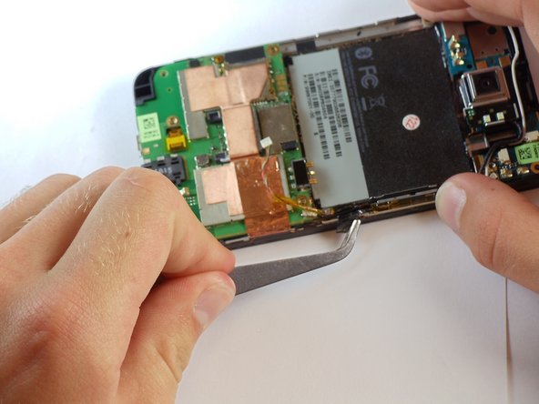

    2. HTC HD2 Camera Replacement: crwdns2935265:06crwdnd2935265:01crwdnd2935265:03crwdne2935265:0 HTC HD2 Camera Replacement: crwdns2935265:06crwdnd2935265:02crwdnd2935265:03crwdne2935265:0 HTC HD2 Camera Replacement: crwdns2935265:06crwdnd2935265:03crwdnd2935265:03crwdne2935265:0
      • Pull the camera flash and cover off of the board.
      • You may need to peel back the sticker that sits behind the battery.
      • Work carefully. Excessive force can damage the camera or motherboard.

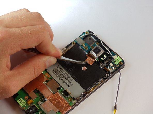

    3. HTC HD2 Camera Replacement: crwdns2935265:07crwdnd2935265:01crwdnd2935265:01crwdne2935265:0
      • Around the camera is a thin shielding. Remove it with tweezers.
      • Using tweezers, remove the primary camera.
