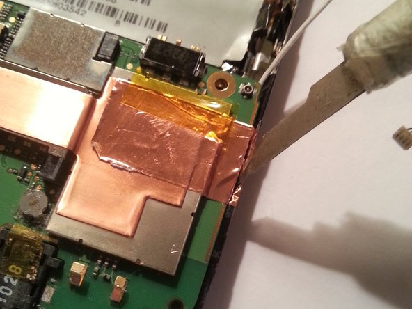

  4. HTC HD 2 Front Panel Replacement, Push it out: crwdns2935265:04crwdnd2935265:01crwdnd2935265:01crwdne2935265:0
    • Use a pry tool along the edges of the device to remove the broken or non-functional screen.

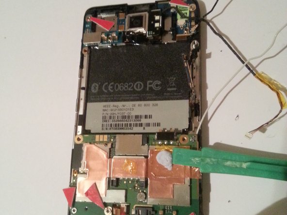

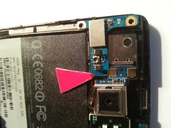

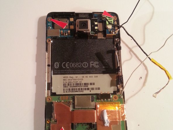

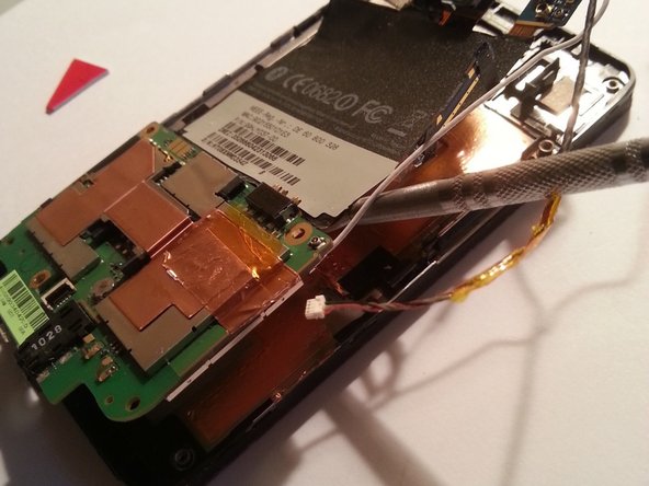

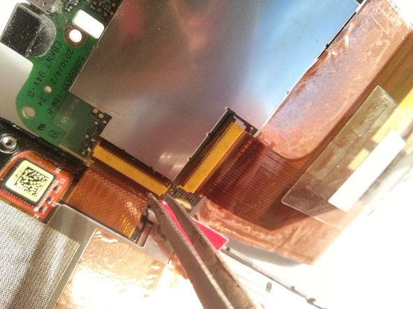

  5. HTC HD 2 Front Panel Replacement, Pull flex cable connections and caution.: crwdns2935265:05crwdnd2935265:01crwdnd2935265:03crwdne2935265:0 HTC HD 2 Front Panel Replacement, Pull flex cable connections and caution.: crwdns2935265:05crwdnd2935265:02crwdnd2935265:03crwdne2935265:0 HTC HD 2 Front Panel Replacement, Pull flex cable connections and caution.: crwdns2935265:05crwdnd2935265:03crwdnd2935265:03crwdne2935265:0
    • Carefully pull the flex cable connections.

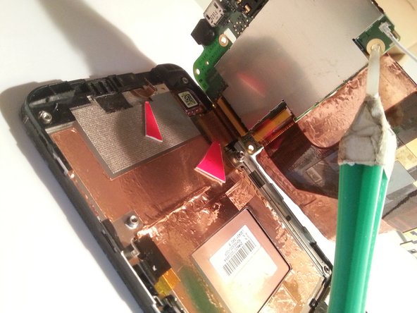

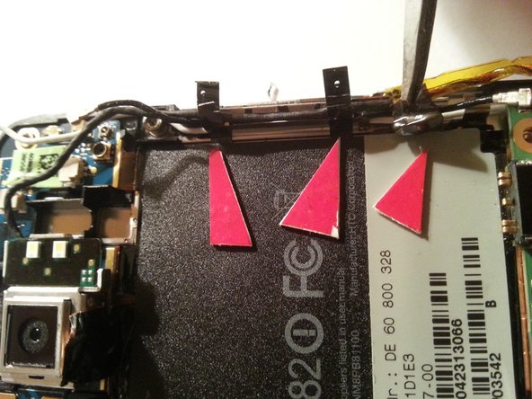

  6. HTC HD 2 Front Panel Replacement, Nur lösen / Anschluss Flex links von Laut/leise buttons: crwdns2935265:06crwdnd2935265:01crwdnd2935265:03crwdne2935265:0 HTC HD 2 Front Panel Replacement, Nur lösen / Anschluss Flex links von Laut/leise buttons: crwdns2935265:06crwdnd2935265:02crwdnd2935265:03crwdne2935265:0 HTC HD 2 Front Panel Replacement, Nur lösen / Anschluss Flex links von Laut/leise buttons: crwdns2935265:06crwdnd2935265:03crwdnd2935265:03crwdne2935265:0

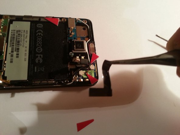

    • Danach 3 tesa stripes lösen
    • Using tweezers, release the 3 tesa strips.

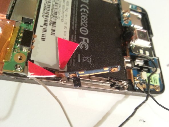

  7. HTC HD 2 Front Panel Replacement: crwdns2935265:07crwdnd2935265:01crwdnd2935265:03crwdne2935265:0 HTC HD 2 Front Panel Replacement: crwdns2935265:07crwdnd2935265:02crwdnd2935265:03crwdne2935265:0 HTC HD 2 Front Panel Replacement: crwdns2935265:07crwdnd2935265:03crwdnd2935265:03crwdne2935265:0

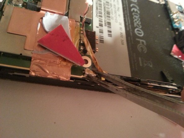

    • Kabel vorsichtig aus dem Kabelschacht ...
    • Carefully remove the cable from its shaft.

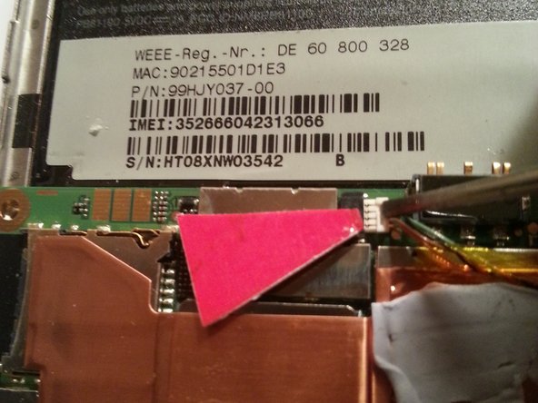

  8. HTC HD 2 Front Panel Replacement, Flex: crwdns2935265:08crwdnd2935265:01crwdnd2935265:03crwdne2935265:0 HTC HD 2 Front Panel Replacement, Flex: crwdns2935265:08crwdnd2935265:02crwdnd2935265:03crwdne2935265:0 HTC HD 2 Front Panel Replacement, Flex: crwdns2935265:08crwdnd2935265:03crwdnd2935265:03crwdne2935265:0
    • FLEX

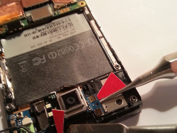

  9. HTC HD 2 Front Panel Replacement, Raushebeln: crwdns2935265:09crwdnd2935265:01crwdnd2935265:03crwdne2935265:0 HTC HD 2 Front Panel Replacement, Raushebeln: crwdns2935265:09crwdnd2935265:02crwdnd2935265:03crwdne2935265:0 HTC HD 2 Front Panel Replacement, Raushebeln: crwdns2935265:09crwdnd2935265:03crwdnd2935265:03crwdne2935265:0
    • Einzelnd
  10. HTC HD 2 Front Panel Replacement, Weiter: crwdns2935265:010crwdnd2935265:01crwdnd2935265:03crwdne2935265:0 HTC HD 2 Front Panel Replacement, Weiter: crwdns2935265:010crwdnd2935265:02crwdnd2935265:03crwdne2935265:0 HTC HD 2 Front Panel Replacement, Weiter: crwdns2935265:010crwdnd2935265:03crwdnd2935265:03crwdne2935265:0
    • Flex

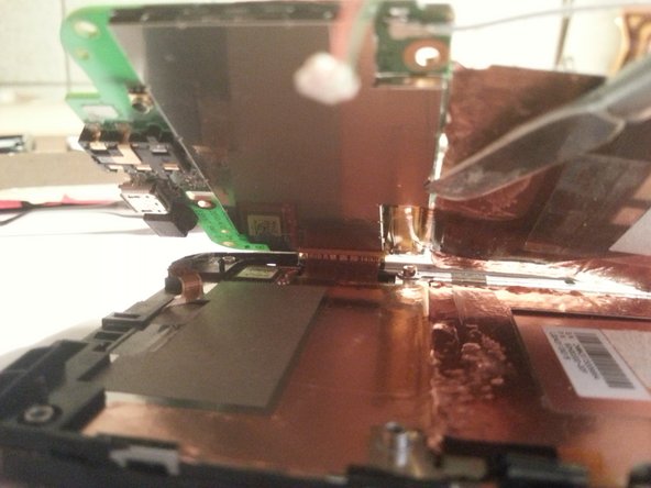

  11. HTC HD 2 Front Panel Replacement, Aufklappen: crwdns2935265:011crwdnd2935265:01crwdnd2935265:03crwdne2935265:0 HTC HD 2 Front Panel Replacement, Aufklappen: crwdns2935265:011crwdnd2935265:02crwdnd2935265:03crwdne2935265:0 HTC HD 2 Front Panel Replacement, Aufklappen: crwdns2935265:011crwdnd2935265:03crwdnd2935265:03crwdne2935265:0
    • Aufklappen
  12. HTC HD 2 Front Panel Replacement, Lösen: crwdns2935265:012crwdnd2935265:01crwdnd2935265:01crwdne2935265:0
    • Vorsichtig
