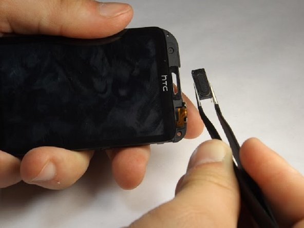

    1. HTC Freestyle Speaker Replacement, Locate and remove speaker: crwdns2935265:012crwdnd2935265:01crwdnd2935265:02crwdne2935265:0 HTC Freestyle Speaker Replacement, Locate and remove speaker: crwdns2935265:012crwdnd2935265:02crwdnd2935265:02crwdne2935265:0
      • The speaker should still be attached to the front of the phone, so push the speaker from the front, or use metal tweezers to grab and remove through the backside of the screen.
