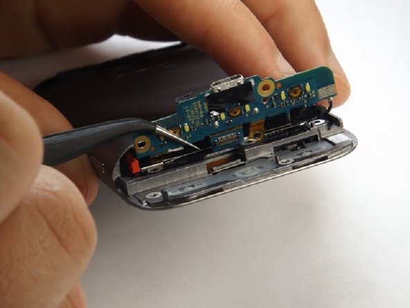

    3. HTC Freestyle Screen Replacement, Remove circuiting panel: crwdns2935265:06crwdnd2935265:01crwdnd2935265:02crwdne2935265:0 HTC Freestyle Screen Replacement, Remove circuiting panel: crwdns2935265:06crwdnd2935265:02crwdnd2935265:02crwdne2935265:0
      • After the screws are removed, fold circuit panel upwards, exposing the phone's primary buttons.
      • In order to remove the circuit board you must disconnect the labeled component.
    4. HTC Freestyle Screen Replacement, Remove primary buttons: crwdns2935265:07crwdnd2935265:01crwdnd2935265:01crwdne2935265:0
      • Once the back side of the buttons are exposed, they will fall out either by punching them out from the front side, or by using tweezers to pull them out of the back.
