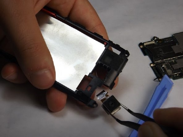

    1. HTC Freestyle Rear Facing Camera Replacement, Locate and remove camera: crwdns2935265:012crwdnd2935265:01crwdnd2935265:02crwdne2935265:0 HTC Freestyle Rear Facing Camera Replacement, Locate and remove camera: crwdns2935265:012crwdnd2935265:02crwdnd2935265:02crwdne2935265:0
      • The camera should still be attached to the battery compartment and can be removed by pushing directly on the lens with either a finger or plastic opening tool.
