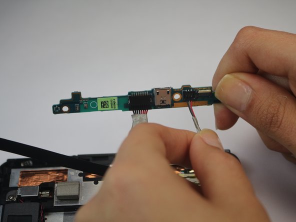

    1. HTC Flyer MicroUSB Port Replacement, MicroUSB Port: crwdns2935265:09crwdnd2935265:01crwdnd2935265:01crwdne2935265:0
      • Use a spudger to unclip the the wires attached to the power jack
      • The clips have a white or black relief tab that, when pressed, releases the wires.

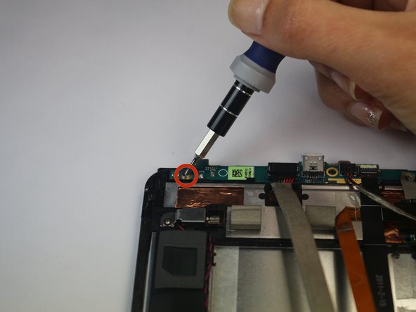

    2. HTC Flyer MicroUSB Port Replacement: crwdns2935265:010crwdnd2935265:01crwdnd2935265:02crwdne2935265:0 HTC Flyer MicroUSB Port Replacement: crwdns2935265:010crwdnd2935265:02crwdnd2935265:02crwdne2935265:0
      • Remove the two 2.5mm Torx T5 screws from both sides of the power jack panel.
    3. HTC Flyer MicroUSB Port Replacement: crwdns2935265:011crwdnd2935265:01crwdnd2935265:02crwdne2935265:0 HTC Flyer MicroUSB Port Replacement: crwdns2935265:011crwdnd2935265:02crwdnd2935265:02crwdne2935265:0
      • Gently remove the power jack panel.
