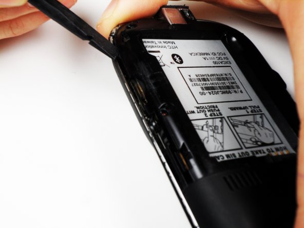

      • After removing the rubber stoppers on top, there should be six exposed screws. Remove these using the T6 screwdriver.
      • Next, use the spudger to loosen the case underneath the shiny metal edge. Go all the way around the phone until completely loosened.
      • The case is superglued on and will not permanently damage the phone when removed, but you should still use caution.
      • After loosening the case, remove it.
      • There is a wire that connects both the top and bottom of the case. If you are not careful when removing the case, you might snap the wire.

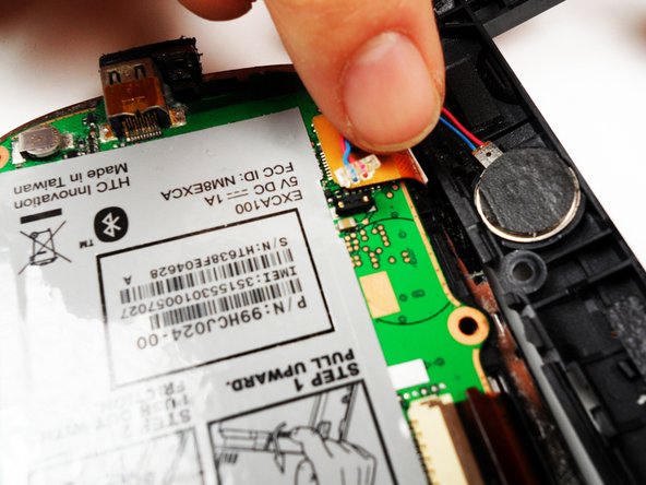

      • Remove the one remaining screw in the logic board.
      • Unclip the wire that connects the back of the case to the logic board.

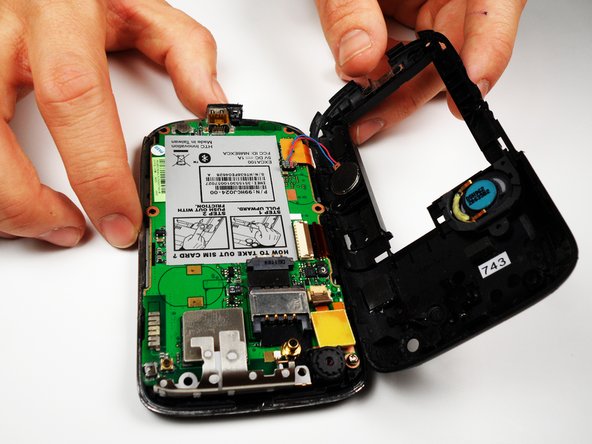

      • On the left side of the phone, there are three copper colored clips.
      • Unclip the bottom clip, thread the middle one through the logic board, and pull the top one out gently.
      • You can then lift the logic board out of the phone.
      • Do this at an angle, lifting the side to the right of the SIM card instructions.
      • One of the strips is attached to the front of the case, and goes through the logic board. Be careful not to break this piece.

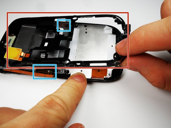

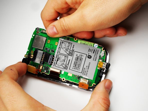

    1. HTC Excalibur Keyboard Replacement, Keyboard: crwdns2935265:06crwdnd2935265:01crwdnd2935265:01crwdne2935265:0
      • Slip out the copper clips attached to the bottom frame
      • Remove the metal frame carefully.

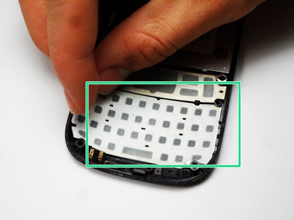

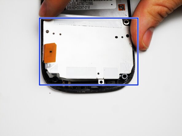

    2. HTC Excalibur Keyboard Replacement: crwdns2935265:07crwdnd2935265:01crwdnd2935265:03crwdne2935265:0 HTC Excalibur Keyboard Replacement: crwdns2935265:07crwdnd2935265:02crwdnd2935265:03crwdne2935265:0 HTC Excalibur Keyboard Replacement: crwdns2935265:07crwdnd2935265:03crwdnd2935265:03crwdne2935265:0
      • Use the Phillip 00 screwdriver to remove the 3 screws.
      • After the screws are removed, remove the metal backing to the keyboard.
      • Peel off the keyboard and replace it with a new one
      • After the keyboard is replaced, re-attach the metal backing to the keyboard and re-insert the 3 screws
