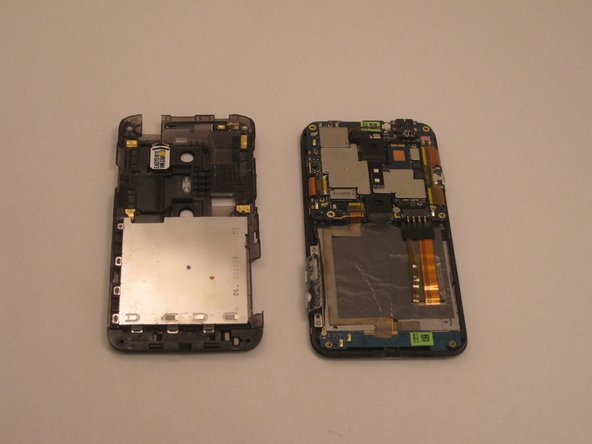

  4. HTC Evo 3D Vibrate Mechanism Replacement: crwdns2935265:04crwdnd2935265:01crwdnd2935265:02crwdne2935265:0 HTC Evo 3D Vibrate Mechanism Replacement: crwdns2935265:04crwdnd2935265:02crwdnd2935265:02crwdne2935265:0
    • With the battery removed, the inner case of the phone can now be removed.
    • Using the plastic opening tool, pry the inner case off at the marked area. Continue prying around the entire perimeter of the phone.
    • This will remove the inner case, and allow access into the inner portion of the phone.
    • Be careful not rip or damage the ribbons inside this shell.

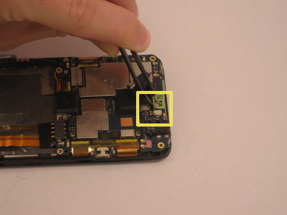

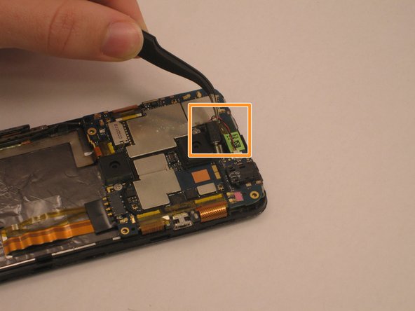

  5. HTC Evo 3D Vibrate Mechanism Replacement: crwdns2935265:05crwdnd2935265:01crwdnd2935265:03crwdne2935265:0 HTC Evo 3D Vibrate Mechanism Replacement: crwdns2935265:05crwdnd2935265:02crwdnd2935265:03crwdne2935265:0 HTC Evo 3D Vibrate Mechanism Replacement: crwdns2935265:05crwdnd2935265:03crwdnd2935265:03crwdne2935265:0
    • The vibrating mechanism is located on the motherboard, on the right.
    • The marked part is the vibrating mechanism.
    • To remove the vibrating mechanism, use the tweezers to securely hold the wire and tug on it.
    • The vibrating unit can then be disconnected from the motherboard using the tweezers, grasping the white part.
