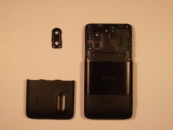

    • Tools Needed: 1. Safety pry tool (guitar pick), 2. Tweezers, 3. Phillips Screwdriver, 4. Star tip Precision Screwdriver, 5. Flathead Screwdriver
  2. HTC EVO Design 4G Camera Lens Replacement, Step 2: crwdns2935265:02crwdnd2935265:01crwdnd2935265:03crwdne2935265:0 HTC EVO Design 4G Camera Lens Replacement, Step 2: crwdns2935265:02crwdnd2935265:02crwdnd2935265:03crwdne2935265:0 HTC EVO Design 4G Camera Lens Replacement, Step 2: crwdns2935265:02crwdnd2935265:03crwdnd2935265:03crwdne2935265:0
    • Use your safety pry tool on the outside edges of the back casing to lift and remove it

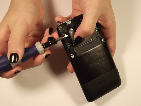

  3. HTC EVO Design 4G Camera Lens Replacement, Step 3: crwdns2935265:03crwdnd2935265:01crwdnd2935265:02crwdne2935265:0 HTC EVO Design 4G Camera Lens Replacement, Step 3: crwdns2935265:03crwdnd2935265:02crwdnd2935265:02crwdne2935265:0
    • Take your flathead and stick it into the holes to the left of the lens and carefully work your way around the perimeter pushing up the lens until it snaps off
  4. HTC EVO Design 4G Camera Lens Replacement, Step 4: crwdns2935265:04crwdnd2935265:01crwdnd2935265:02crwdne2935265:0 HTC EVO Design 4G Camera Lens Replacement, Step 4: crwdns2935265:04crwdnd2935265:02crwdnd2935265:02crwdne2935265:0
    • Remove old lens.
    • Place replacement lens over the camera lens and it should loosely snap on
    • Info*: Don’t worry if the cover is loose because the cover of the phone would hold it in place
  5. HTC EVO Design 4G Camera Lens Replacement, Step 5: crwdns2935265:05crwdnd2935265:01crwdnd2935265:01crwdne2935265:0
    • Snap the cover back into place
