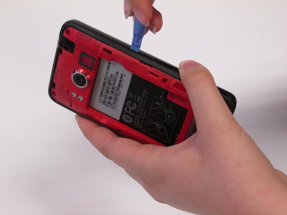

    • Remove the back case of the phone with a plastic opening tool by placing the tool in the tab on the back of the phone.

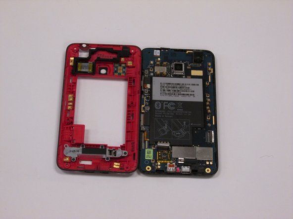

    • Using the plastic opening tools again, gently pry the inner frame apart from the rest of the phone
    • Remove the inner frame from the rest of the phone by lifting it off
