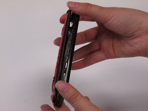

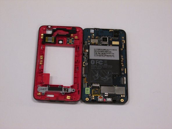

  5. HTC EVO 4G Speaker Replacement: crwdns2935265:05crwdnd2935265:01crwdnd2935265:03crwdne2935265:0 HTC EVO 4G Speaker Replacement: crwdns2935265:05crwdnd2935265:02crwdnd2935265:03crwdne2935265:0 HTC EVO 4G Speaker Replacement: crwdns2935265:05crwdnd2935265:03crwdnd2935265:03crwdne2935265:0
    • Using the plastic opening tool again, gently pry the inner frame apart from the rest of the phone
    • Remove the inner frame from the rest of the phone by lifting it off
  6. HTC EVO 4G Speaker Replacement: crwdns2935265:06crwdnd2935265:01crwdnd2935265:01crwdne2935265:0
    • use plastic pic to gently pry our the speaker
    • be sure to have your replacement unit ready
