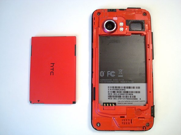

      • Insert a fingertip into the gap between the battery and the rear inner frame, located between the battery and the speaker. Slide the battery away from the speaker, widening the gap.
      • Lift the top of the battery up and remove the battery from the rear inner frame.

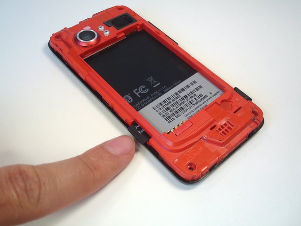

    1. HTC Droid Incredible Rear Inner Frame Replacement, MicroSD card: crwdns2935265:04crwdnd2935265:01crwdnd2935265:02crwdne2935265:0 HTC Droid Incredible Rear Inner Frame Replacement, MicroSD card: crwdns2935265:04crwdnd2935265:02crwdnd2935265:02crwdne2935265:0
      • Press the MicroSD card further into its slot until it clicks.
      • Release the MicroSD card, and it will pop out slightly.

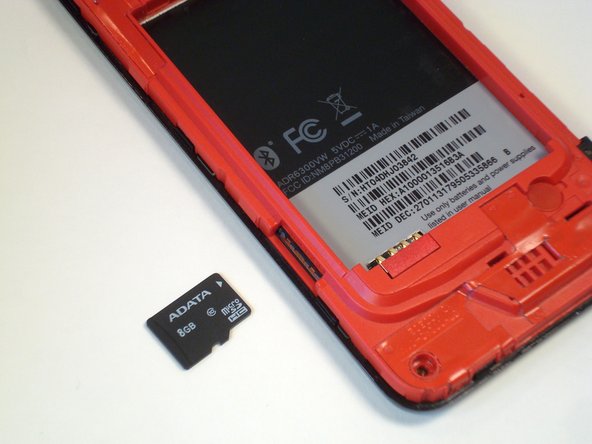

    2. HTC Droid Incredible Rear Inner Frame Replacement: crwdns2935265:05crwdnd2935265:01crwdnd2935265:02crwdne2935265:0 HTC Droid Incredible Rear Inner Frame Replacement: crwdns2935265:05crwdnd2935265:02crwdnd2935265:02crwdne2935265:0
      • Pull the MicroSD card straight out of its slot.

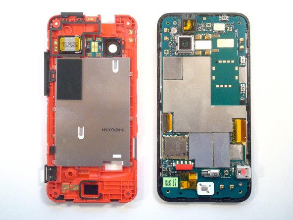

    1. HTC Droid Incredible Rear Inner Frame Replacement, Rear Inner Frame: crwdns2935265:06crwdnd2935265:01crwdnd2935265:01crwdne2935265:0
      • Remove four T6 Torx screws securing the rear inner frame to the front case.
    2. HTC Droid Incredible Rear Inner Frame Replacement: crwdns2935265:07crwdnd2935265:01crwdnd2935265:01crwdne2935265:0

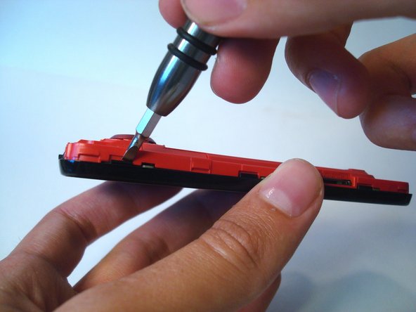

      • The rear inner frame is attached to the front case by nine plastic clips, marked here for reference.

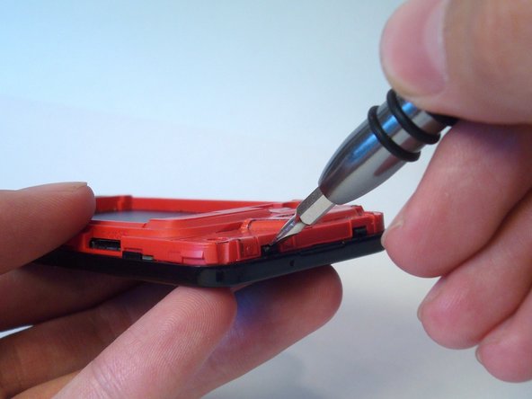

    3. HTC Droid Incredible Rear Inner Frame Replacement: crwdns2935265:08crwdnd2935265:01crwdnd2935265:02crwdne2935265:0 HTC Droid Incredible Rear Inner Frame Replacement: crwdns2935265:08crwdnd2935265:02crwdnd2935265:02crwdne2935265:0
      • Starting on the bottom of the phone, gently push in on the (red) rear inner frame behind each black clip with a small flathead screwdriver.
      • Go slow and be gentle, you may have to go back and forth between each side several times to work the rear inner case free.

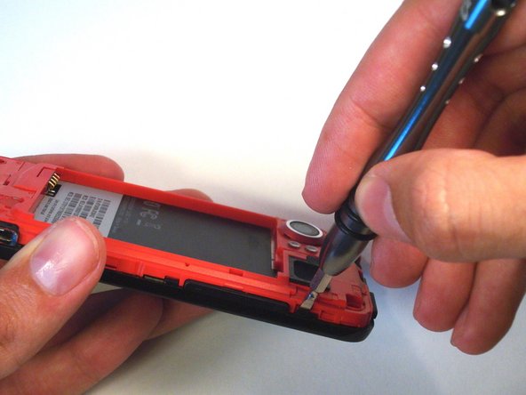

    4. HTC Droid Incredible Rear Inner Frame Replacement: crwdns2935265:09crwdnd2935265:01crwdnd2935265:02crwdne2935265:0 HTC Droid Incredible Rear Inner Frame Replacement: crwdns2935265:09crwdnd2935265:02crwdnd2935265:02crwdne2935265:0
      • Loosen the clips on the side next to the camera using the method described in the previous step.
    5. HTC Droid Incredible Rear Inner Frame Replacement: crwdns2935265:010crwdnd2935265:01crwdnd2935265:02crwdne2935265:0 HTC Droid Incredible Rear Inner Frame Replacement: crwdns2935265:010crwdnd2935265:02crwdnd2935265:02crwdne2935265:0
      • Rotate the phone 180 degrees and loosen the three clips on the side by the speaker. Note that the middle clip on this side is smaller than the others.

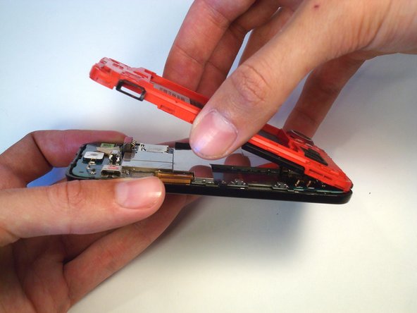

      • Use the same technique to loosen the clip on the top of the phone.
      • You may need to gently lift the bottom of the rear inner frame to free this clip.

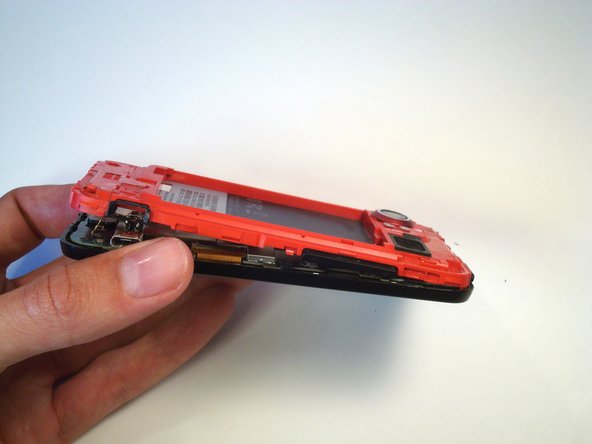

    7. HTC Droid Incredible Rear Inner Frame Replacement: crwdns2935265:012crwdnd2935265:01crwdnd2935265:02crwdne2935265:0 HTC Droid Incredible Rear Inner Frame Replacement: crwdns2935265:012crwdnd2935265:02crwdnd2935265:02crwdne2935265:0
      • Remove the rear inner frame.
