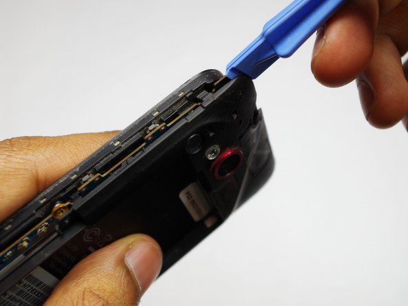

HTC Droid Incredible 4G LTE Display Assembly Replacement
  1. HTC Droid Incredible 4G LTE Display Assembly Replacement, Battery: crwdns2935265:01crwdnd2935265:01crwdnd2935265:01crwdne2935265:0
    • Use the plastic opening tool to pry off back cover by inserting opening tool in the space indicated and pushing down on the handle of the tool.
  2. HTC Droid Incredible 4G LTE Display Assembly Replacement: crwdns2935265:02crwdnd2935265:01crwdnd2935265:01crwdne2935265:0
    • Remove the battery after taking off the cover.

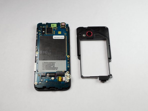

  3. HTC Droid Incredible 4G LTE Display Assembly Replacement, Midframe: crwdns2935265:03crwdnd2935265:01crwdnd2935265:01crwdne2935265:0
    • Remove eight 4mm and one 5mm Torx screws.
  4. HTC Droid Incredible 4G LTE Display Assembly Replacement: crwdns2935265:04crwdnd2935265:01crwdnd2935265:02crwdne2935265:0 HTC Droid Incredible 4G LTE Display Assembly Replacement: crwdns2935265:04crwdnd2935265:02crwdnd2935265:02crwdne2935265:0
    • Use a prying tool to pry off the midframe.

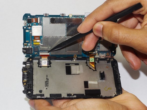

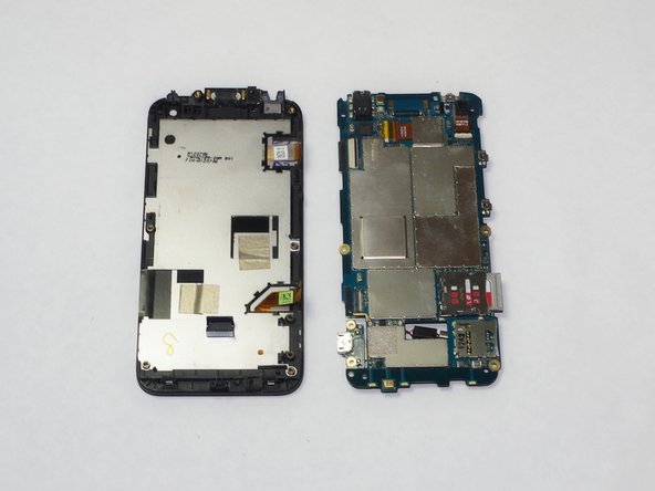

  9. HTC Droid Incredible 4G LTE Display Assembly Replacement: crwdns2935265:09crwdnd2935265:01crwdnd2935265:01crwdne2935265:0
    • Remove the 4mm Torx screw.
  10. HTC Droid Incredible 4G LTE Display Assembly Replacement: crwdns2935265:010crwdnd2935265:01crwdnd2935265:03crwdne2935265:0 HTC Droid Incredible 4G LTE Display Assembly Replacement: crwdns2935265:010crwdnd2935265:02crwdnd2935265:03crwdne2935265:0 HTC Droid Incredible 4G LTE Display Assembly Replacement: crwdns2935265:010crwdnd2935265:03crwdnd2935265:03crwdne2935265:0
    • Remove tabs holding the motherboard to the phone.
