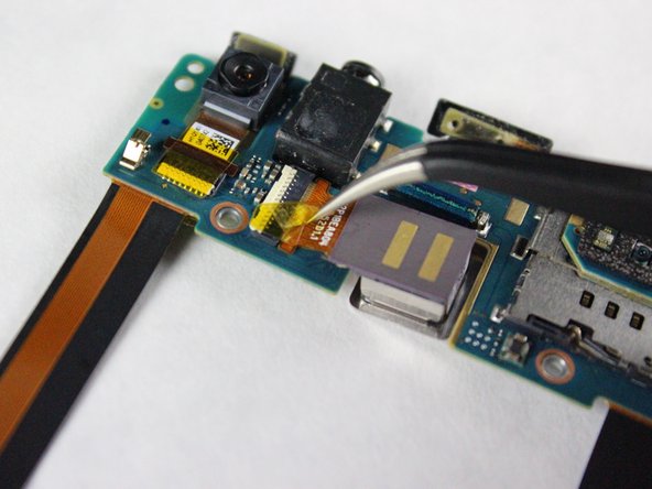

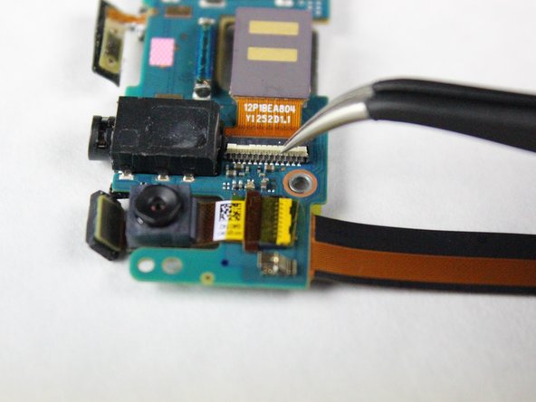

    1. HTC Droid DNA Rear-Facing Camera Replacement, Remove Yellow Tape: crwdns2935265:028crwdnd2935265:01crwdnd2935265:02crwdne2935265:0 HTC Droid DNA Rear-Facing Camera Replacement, Remove Yellow Tape: crwdns2935265:028crwdnd2935265:02crwdnd2935265:02crwdne2935265:0
      • Use your tweezers to gently pull off the two pieces of yellow tape in the center of the camera board.
    2. HTC Droid DNA Rear-Facing Camera Replacement, White Connector Clip: crwdns2935265:029crwdnd2935265:01crwdnd2935265:02crwdne2935265:0 HTC Droid DNA Rear-Facing Camera Replacement, White Connector Clip: crwdns2935265:029crwdnd2935265:02crwdnd2935265:02crwdne2935265:0
      • Use your tweezers to gently flip the white connector board into the upright position.
    3. HTC Droid DNA Rear-Facing Camera Replacement, Remove Rear-Facing Camera: crwdns2935265:030crwdnd2935265:01crwdnd2935265:01crwdne2935265:0
      • Use your tweezers to remove the rear-facing camera from the camera board.
