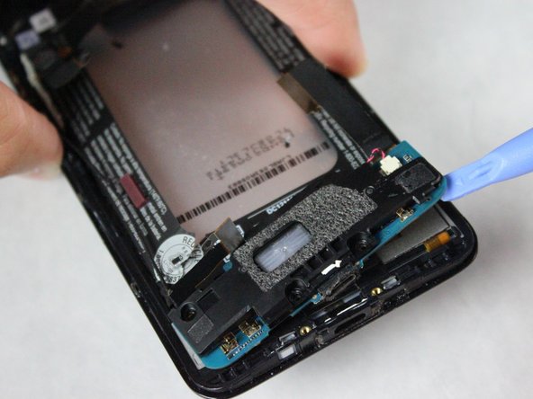

    1. HTC Droid DNA Micro USB Port Replacement, Remove the Charging Port Assembly: crwdns2935265:025crwdnd2935265:01crwdnd2935265:02crwdne2935265:0 HTC Droid DNA Micro USB Port Replacement, Remove the Charging Port Assembly: crwdns2935265:025crwdnd2935265:02crwdnd2935265:02crwdne2935265:0
      • Use the plastic prying tool to gently remove the charging port assembly.

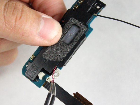

    3. HTC Droid DNA Micro USB Port Replacement, Undo the Wire Connection: crwdns2935265:027crwdnd2935265:01crwdnd2935265:02crwdne2935265:0 HTC Droid DNA Micro USB Port Replacement, Undo the Wire Connection: crwdns2935265:027crwdnd2935265:02crwdnd2935265:02crwdne2935265:0
      • Use your tweezers to undo the red and black wire connection.

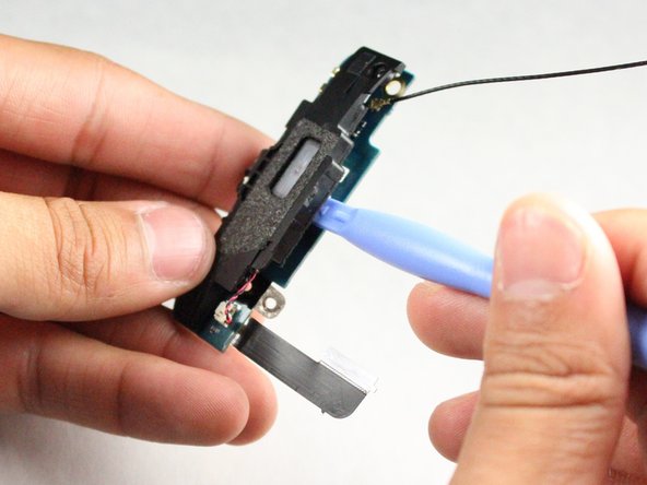

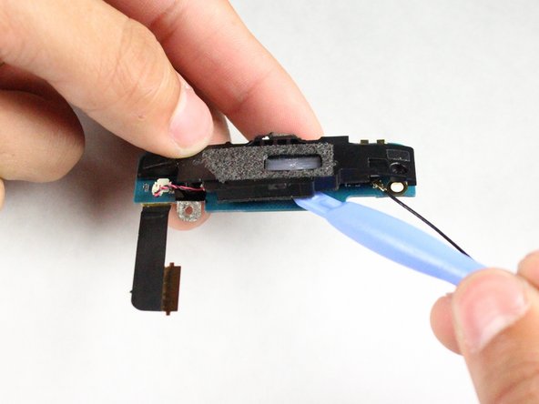

    4. HTC Droid DNA Micro USB Port Replacement, Separate the Black and Blue Assembly Pieces: crwdns2935265:028crwdnd2935265:01crwdnd2935265:03crwdne2935265:0 HTC Droid DNA Micro USB Port Replacement, Separate the Black and Blue Assembly Pieces: crwdns2935265:028crwdnd2935265:02crwdnd2935265:03crwdne2935265:0 HTC Droid DNA Micro USB Port Replacement, Separate the Black and Blue Assembly Pieces: crwdns2935265:028crwdnd2935265:03crwdnd2935265:03crwdne2935265:0
      • Use the plastic prying tool to separate the assembly into two pieces: blue and black.

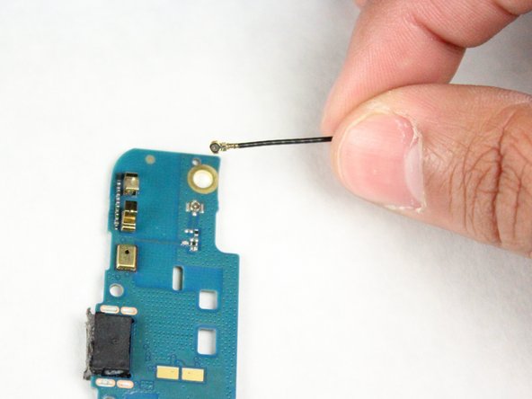

    1. HTC Droid DNA Micro USB Port Replacement, Remove the wire: crwdns2935265:029crwdnd2935265:01crwdnd2935265:02crwdne2935265:0 HTC Droid DNA Micro USB Port Replacement, Remove the wire: crwdns2935265:029crwdnd2935265:02crwdnd2935265:02crwdne2935265:0
      • Remove the black wire on the blue piece (the Micro USB charging port) so it is out of the way and cannot get damaged.
      • If the micro USB port is damaged, the charging port may need to be replaced.
