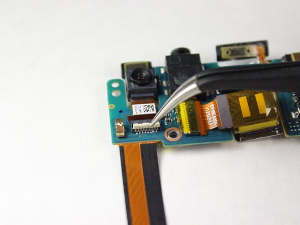

    1. HTC Droid DNA Front-Facing Camera Replacement, Remove Yellow Tape: crwdns2935265:028crwdnd2935265:01crwdnd2935265:01crwdne2935265:0
      • Use your tweezers to gently remove the yellow tape on the far left side of the camera board.
    2. HTC Droid DNA Front-Facing Camera Replacement, Release the White Connector Clip: crwdns2935265:029crwdnd2935265:01crwdnd2935265:02crwdne2935265:0 HTC Droid DNA Front-Facing Camera Replacement, Release the White Connector Clip: crwdns2935265:029crwdnd2935265:02crwdnd2935265:02crwdne2935265:0
      • Use your tweezers to gently flip the white connector clip into the upright position.
    3. HTC Droid DNA Front-Facing Camera Replacement, Remove Front-Facing Camera: crwdns2935265:030crwdnd2935265:01crwdnd2935265:01crwdne2935265:0
      • Use your tweezers to gently pull the front facing camera off the camera board.
